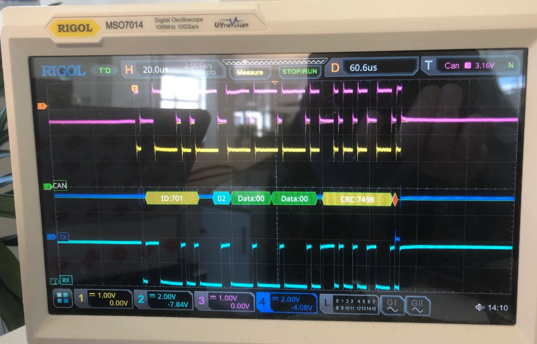

when I try to receive a CAN-Frame it is not received by the Microcontroller, it is within the range, I have no idea what the issue is.
Thanks to everybody in advance, Best Regards, Seppel

P.S. TX works perfectly fine, as you can see it Ack's the 0x701 Frame that was received.

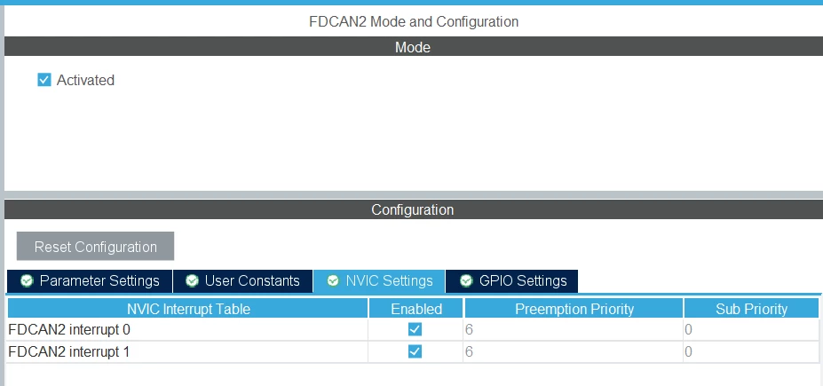

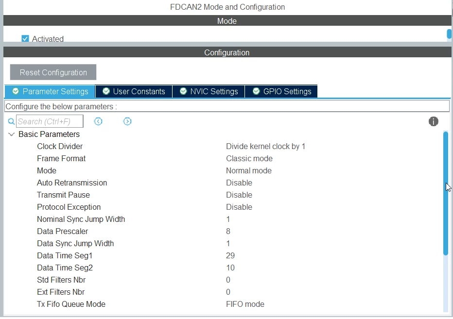

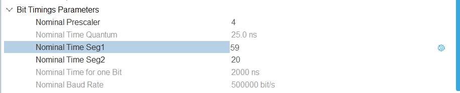

AndrewST
April 4, 2023
The screenshot I took is for an F series MPU, but as far as FDCAN is concerned, this should be very similar to the Gs.
AndrewST
April 4, 2023
Can you copy-paste the FDCAN_InitTypeDef structure declaration that was generated?

AndrewST
April 4, 2023
I am just another user who has FDCAN working on a somewhat similar MPU, that's all.
LCE
Principal II
April 4, 2023
I don't know how similar G4 / H7 FDCANs are, so all of the following might only apply to the H7.
The H7 has some 10 kB SRAM reserved for FDCAN.
This "CAN-RAM" is used for:
  • filter settings
  • RX & TX buffers and FIFOs
The RAM layout depends on your INIT settings, how many filters, buffers, etcpp you assign.
Then it calculates the RAM (starting) addresses / pointers from that.
First thing I see in your init:
StdFiltersNbr = 0; ExtFiltersNbr = 0;
Which means you have no filters assigned to memory.
Comparing to my H7 source, I also miss the settings for RX & TX buffers & FIFO, so my H7 init looks like this:

seppeltronics_v
April 12, 2023
the issue is resolved:
Issue visible in the Code:
hfdcan2.Init.StdFiltersNbr = 0;
Solution, change the Config in the Stm32CubeIde, set the number of filters to 1, the generated code will be:
hfdcan2.Init.StdFiltersNbr = 1;
Thanks a lot to everybody supporting the case.
P.S. It is so obvious that if you use a filter the number of filters should not be zero. But as always: "You know afterwards, what you could have known in advance". 8)
