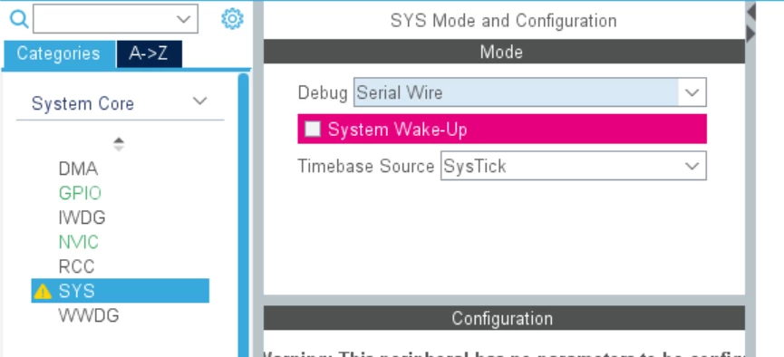

Hi @LCice.2​ ,
Thanks for your feedback, what you have mentioned are not actually warning messages but rather a Contextual Help window and it is displayed when hovering the mouse over the peripheral. By default, the window displays the extended name and source of configuration conflicts.
Taking one of your screenshots for example:
0693W000007ELPIQA4.pngThis message indicated that some SYS configurations can't be done because of conflict with GPIO Output signal mapped in the PA0_WKUP pin, if you open the SYS Mode and Configuration panel, System Wake-Up can't be checked :
Furthermore, this conflict is due to the fact that WKUP signal can't be remapped to any pin other than PA0. For more details about Pinouts and pin description, please refer to STM32F103xB Data Sheet.
Hope this clarifies the displayed tooltips.
Khouloud.

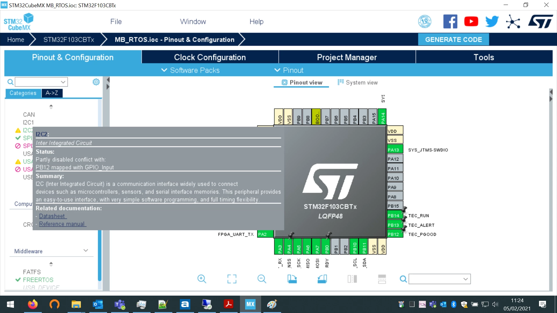

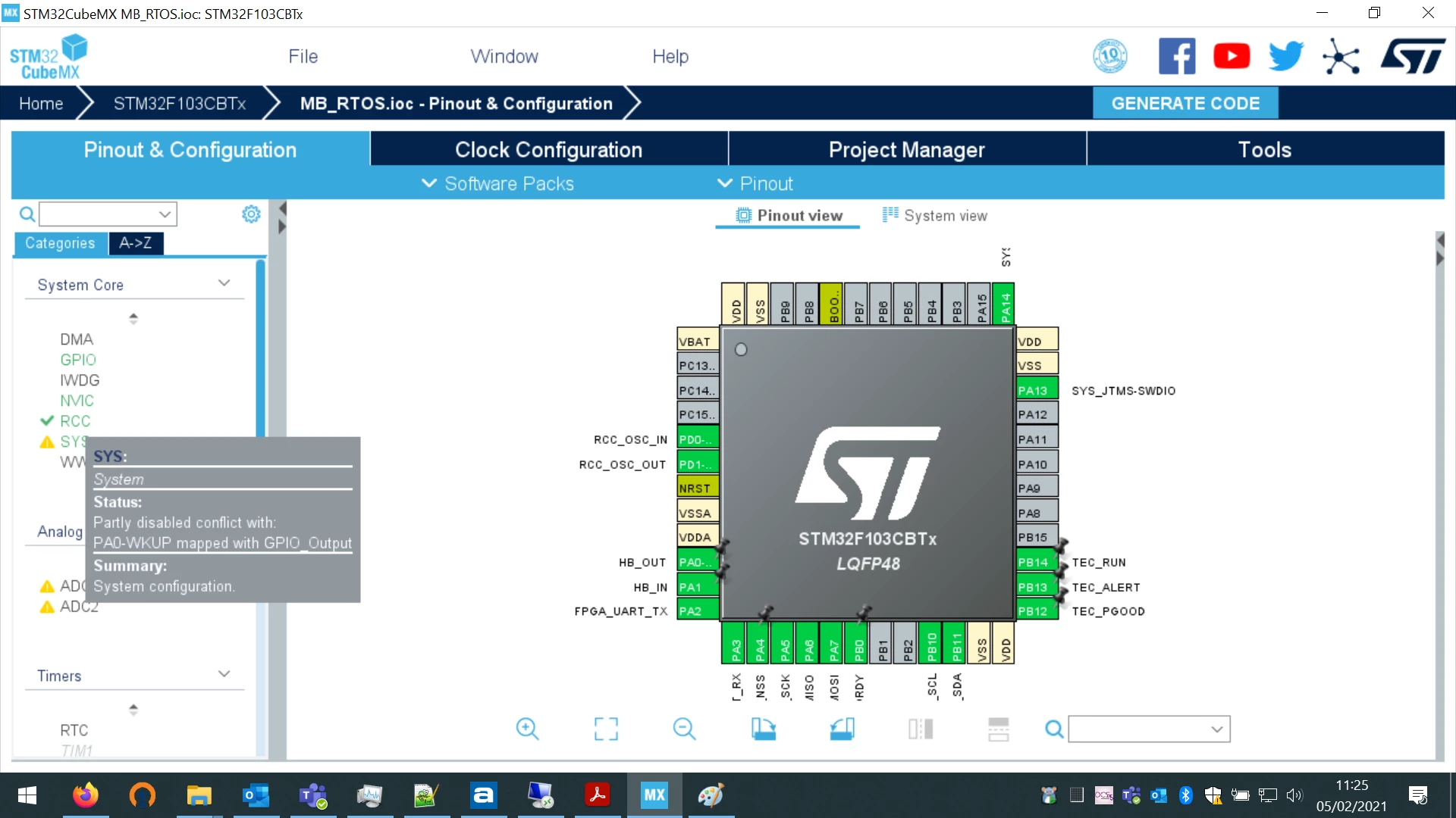

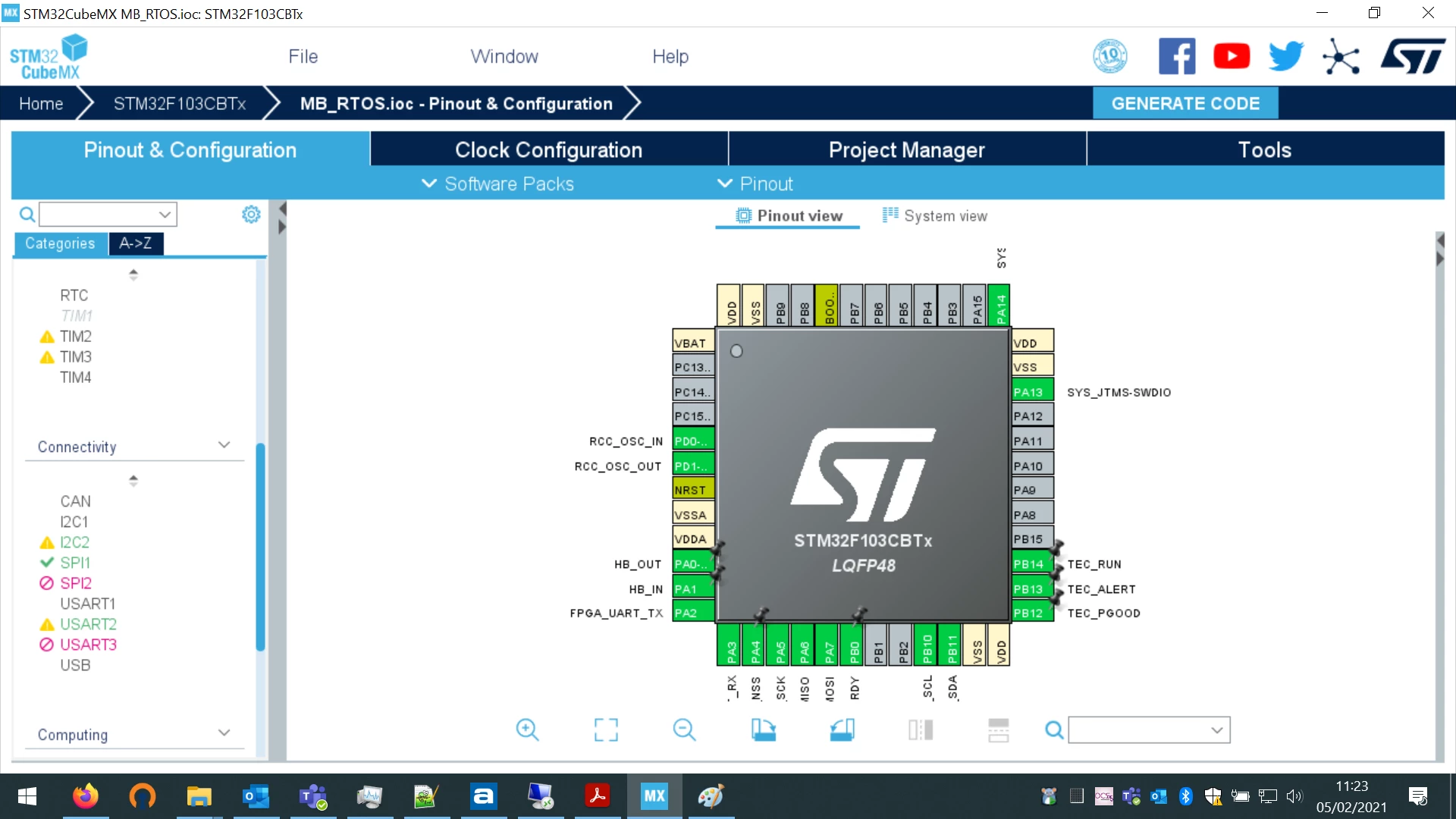

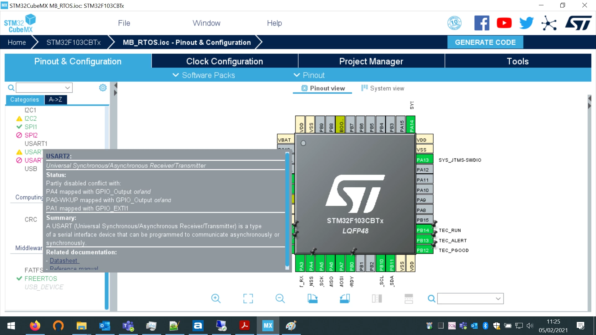

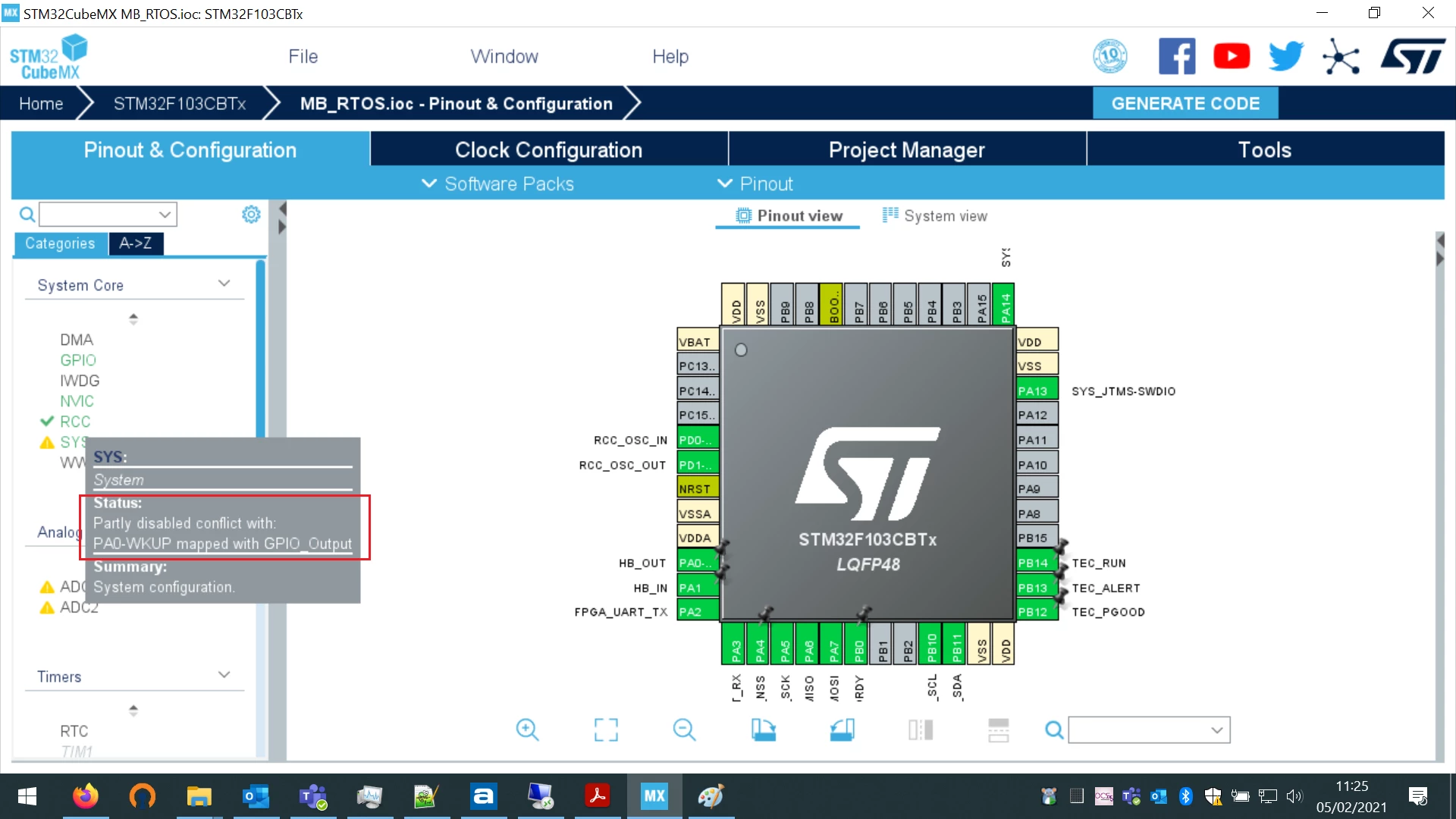

The warnings I was speaking about are not the initial warnings, when I first i open the old project.
( I already made the choice to keep the original firmoware, no migration. )
These warnings are present in the main window of CubeMX, on the left.
And I do not immediately understand what these warnings are trying to say.
( I am now trying to load the screenshots.)

Hi @LCice.2​ ,
Khouloud.
