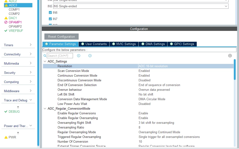

Can anyone explain how to enable the ADC Clock Source on an STM32H753ZI using STM32 Cube?
I'm new to Cube IDE and Cube MX but I've been trying to create a simple project based on an STM32H753ZI to investigate ADC capture.
Having enabled a few channels on ADC3 I looked in the clock tree to find the ADC clock speed but it's greyed out. When I hover over the ADC Clock Mux section I get a message saying "ADC Clock Source is not available" and to configure one in the Pinout Tab ADC.
I can't see any options that mention anything to do with a clock in the ADC section (or , I've seen screenshots from the STM32H743 where there is a "Clock Prescaler" option under ADC_Settings, but I don't see this option in my case. I've seen that sometimes options only become visible when other options have first been set, so hopefully this is something simple that I've overlooked.

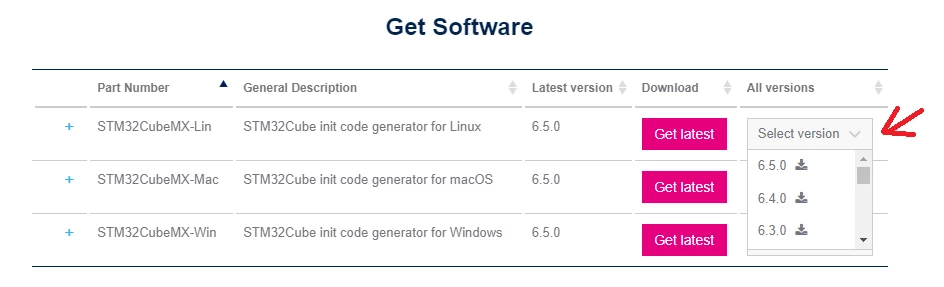

You can download CubeMx separetly from this link and generate code for CubeIDE. Go to "Select version" menu to download an older version:
0693W00000LwRBkQAN.pngYou can open a new thread for the latest issue you reported.
Thank you for your understanding.

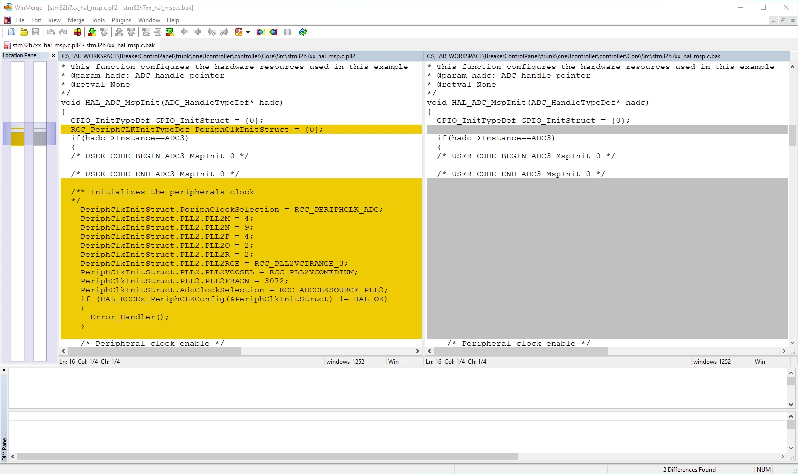

I have been fighting against the same problem for the last few weeks. At one point in time, the ADC clock was miraculously turned on in CubeMX. Instead of fighting another battle against CubeIDE/CubeMX installation, I saved the working version of the stm32h7xx_hal_msp.c and reused it over the new one created by CubeMX.
Attached are the diff screenshot and function code.
