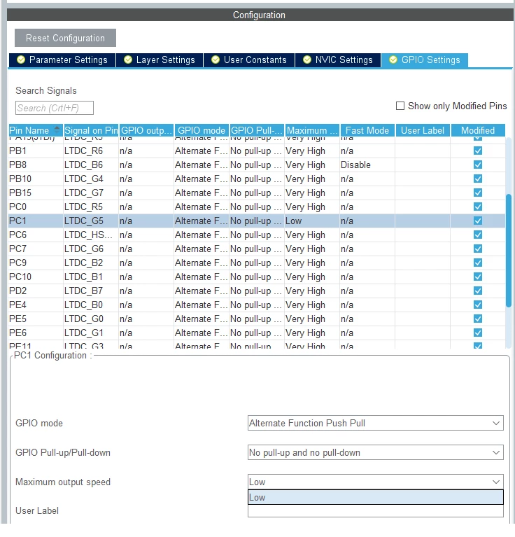

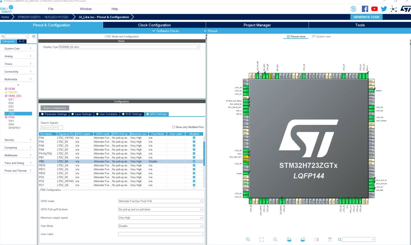

CubeMX doesn't let change the speed for the LTDC Pin PB11 to High, it only accepts "low",

I opened your project, and I could change PB11 speed.

Marco.D
Marco.DAuthor
Oct 29, 2020 11:59 AM UTC
Hi Mike,
thanks.
Regarding PB11: I have the problem when G5 is configured on PC1, moving it to PB11 solved it for me as well
