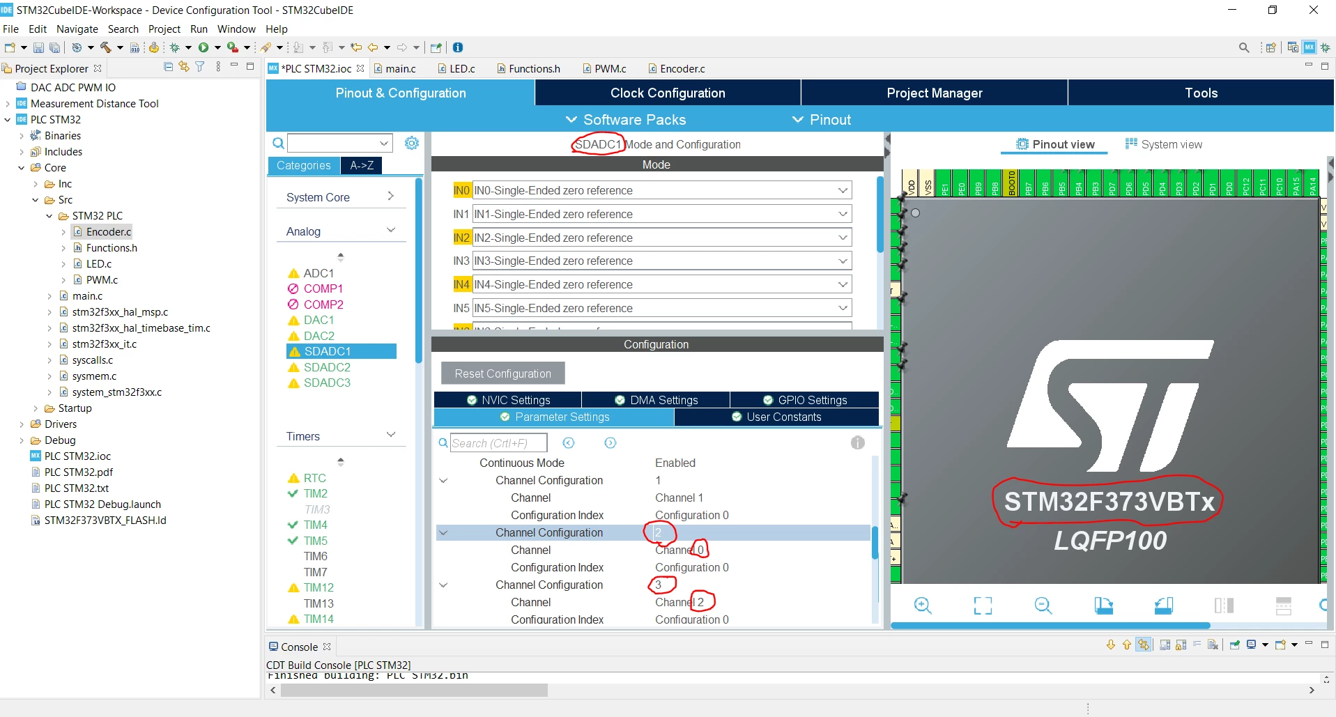

BUG: Wrong indexing in SDADC when using Injection Mode
Hi!
I just want to tell you ST-developers that I have found something that don't looks correct.
Wrong indexing in SDADC. Have a look. STM32CubeIDE 1.6.1

Jun 13, 2021 6:29 PM UTC
You've circled a bunch of numbers, but what is wrong about it? What are you expecting instead?

Jun 13, 2021 7:46 PM UTC
I'm expecting 0,1,2,3,4,5,6,7,8. Not Randomly indexed.

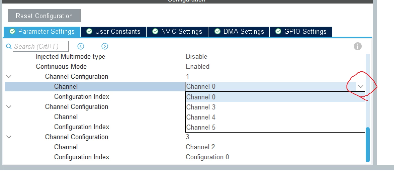

Jun 13, 2021 7:57 PM UTC
The "channel configuration" is the order in which they're converted and is in order (1, 2, 3).
You can change the "channel" to whatever order you want.

Jun 13, 2021 7:58 PM UTC
Sorry. But I can't do that in my STM32CubeIDE 1.6.0.

TDKBest answer
Jun 13, 2021 8:06 PM UTC
Temporarily reduce the "number of channels to be converted" by 1, change the order to what you want, then change it back to add the last channel.
