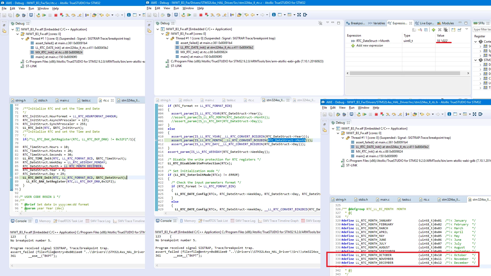

Bug with L4's Low Layer RTC month macros
#define LL_RTC_MONTH_JANUARY (uint8_t)0x01 /*!< January */
#define LL_RTC_MONTH_FEBRUARY (uint8_t)0x02 /*!< February */
#define LL_RTC_MONTH_MARCH (uint8_t)0x03 /*!< March */
#define LL_RTC_MONTH_APRIL (uint8_t)0x04 /*!< April */
#define LL_RTC_MONTH_MAY (uint8_t)0x05 /*!< May */
#define LL_RTC_MONTH_JUNE (uint8_t)0x06 /*!< June */
#define LL_RTC_MONTH_JULY (uint8_t)0x07 /*!< July */
#define LL_RTC_MONTH_AUGUST (uint8_t)0x08 /*!< August */
#define LL_RTC_MONTH_SEPTEMBER (uint8_t)0x09 /*!< September */
#define LL_RTC_MONTH_OCTOBER (uint8_t)0x10 /*!< October */
#define LL_RTC_MONTH_NOVEMBER (uint8_t)0x11 /*!< November */
#define LL_RTC_MONTH_DECEMBER (uint8_t)0x12 /*!< December */
Those values should be: 0xA, 0xB, 0xC - isn't it?
I'm able to set month to decimal 11, 12. But hex 11 12 is decimal 17, 18 which is instant assert fail in LL_RTC_DATE_Init.

Hi dear customer and dear support,
The define is OK. It is BCD format and it is in line with the Hardware.
Now in LL, the API accepts two input formats (Binary or BCD) =>
ErrorStatus LL_RTC_DATE_Init(RTC_TypeDef *RTCx, uint32_t RTC_Format, LL_RTC_DateTypeDef *RTC_DateStruct)
1°) if user choose Format = RTC_FORMAT_BCD
The define is OK and value is directly put in register (after a shift).
2°) if user choose Format = RTC_FORMAT_BIN
if user do not use the define (BCD) but binary value, it is ok.
if user uses the define (BCD), it is converted to binary inside the driver by the following code :
if ((Format == RTC_FORMAT_BIN) && ((sDate->Month & 0x10U) == 0x10U))
 sDate->Month = (uint8_t)((sDate->Month & (uint8_t)~(0x10U)) + (uint8_t)0x0AU);
Now, there is only one assert and the assert should check binary value.
 if (Format == RTC_FORMAT_BIN)
  assert_param(IS_RTC_MONTH(sDate->Month)); /* Binary */
 else
  assert_param(IS_RTC_MONTH(RTC_Bcd2ToByte(sDate->Month))); /* Binary */
The problem is in the assert. Please use :
Use #define IS_LL_RTC_MONTH(__MONTH__) (((__MONTH__) >= 1U) && ((__MONTH__) <= 12U))

This issue is fixed in the available release STM32CubeL4 V1.14.0
Regards,
Imen
