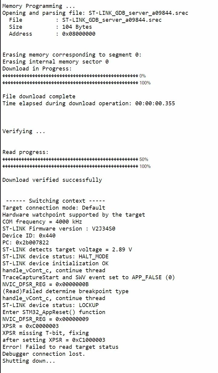

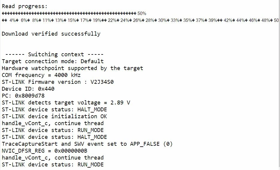

After update the CubeMX from 5.3 to 5.4, and I change the IOC and generate a new code, a error appear and debug is disconnected.
Before the update:
After the update:
I doesnt change nothing in the code, just change a GPIO_Input to Output.
