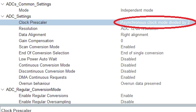

There is a bug in the STM32CubeMX when you change the "Clock Prescaler" of the ADC for the STM32G474RE mcu.
When i change the value of ADC1, the "Clock Prescaler" values of all the other ADC are also changed to the same value of ADC1.

Not yet resilved in cube mx 5.6
