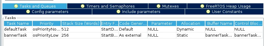

BUG: STM32CubeMX Task Stack Size, words Vs bytes.
  • February 3, 2020
  • 7 replies
  • 5112 views
0690X00000BxopVQAR.pngThe GUI interface for defining FreeRTOS tasks dictates that stack size is specified in words. That generates a call to CMSIS V2's osThreadNew() which requires attributes.stack_size to be specified in bytes. (The CMSIS layer then divides that by 4 to convert it back words before passing it to FreeRTOS which dictates it's specified in words).
The GUI gets it right for Static tasks, but appears to get it wrong for Dynamic tasks. For example, the above selection in the GUI produces the following correct code for the static case. It declares the array to be 256 words long, and sets stack size to 1024 bytes.
uint32_t bannerTaskBuffer[ 256 ];
osStaticThreadDef_t bannerTaskControlBlock;
const osThreadAttr_t bannerTask_attributes = {
 .name = "bannerTask",
 .stack_mem = &bannerTaskBuffer[0],
 .stack_size = sizeof(bannerTaskBuffer),
In contrast, the size for the dynamic task is passed through to .stack_size unchanged:
const osThreadAttr_t defaultTask_attributes = {
 .name = "defaultTask",
 .priority = (osPriority_t) osPriorityNormal,
 .stack_size = 512
so it's requesting 512 bytes as per the CMSIS V2 API, which the intermediate layer turns into 128 words before calling down to FreeRTOS. So while I specified 512 words in the GUI, I only got 1/4 of that.

Khouloud ZEMMELI
February 5, 2020
@David Bathurst​  Issue fixed , you will receive the fix with the 5.6.0 MX version.
Thanks for your feedback.

MShao.1
July 28, 2021
For version 6.2.0 of cubemx software, select stm32l562vetx chip and use FreeRTOS CMOS V2, there will be the same problem. But after I change f429ze, the generated code will see stack_ size“*4�?。

Could you please switch to the latest CubeMX version 6.3.0?
If you still face a problem, please share your ioc file to check it.
I'll be waiting for your feedback :)
Thanks, Khouloud
MShao.1
August 14, 2021
"6.3.0" is OK.:ok_hand:
