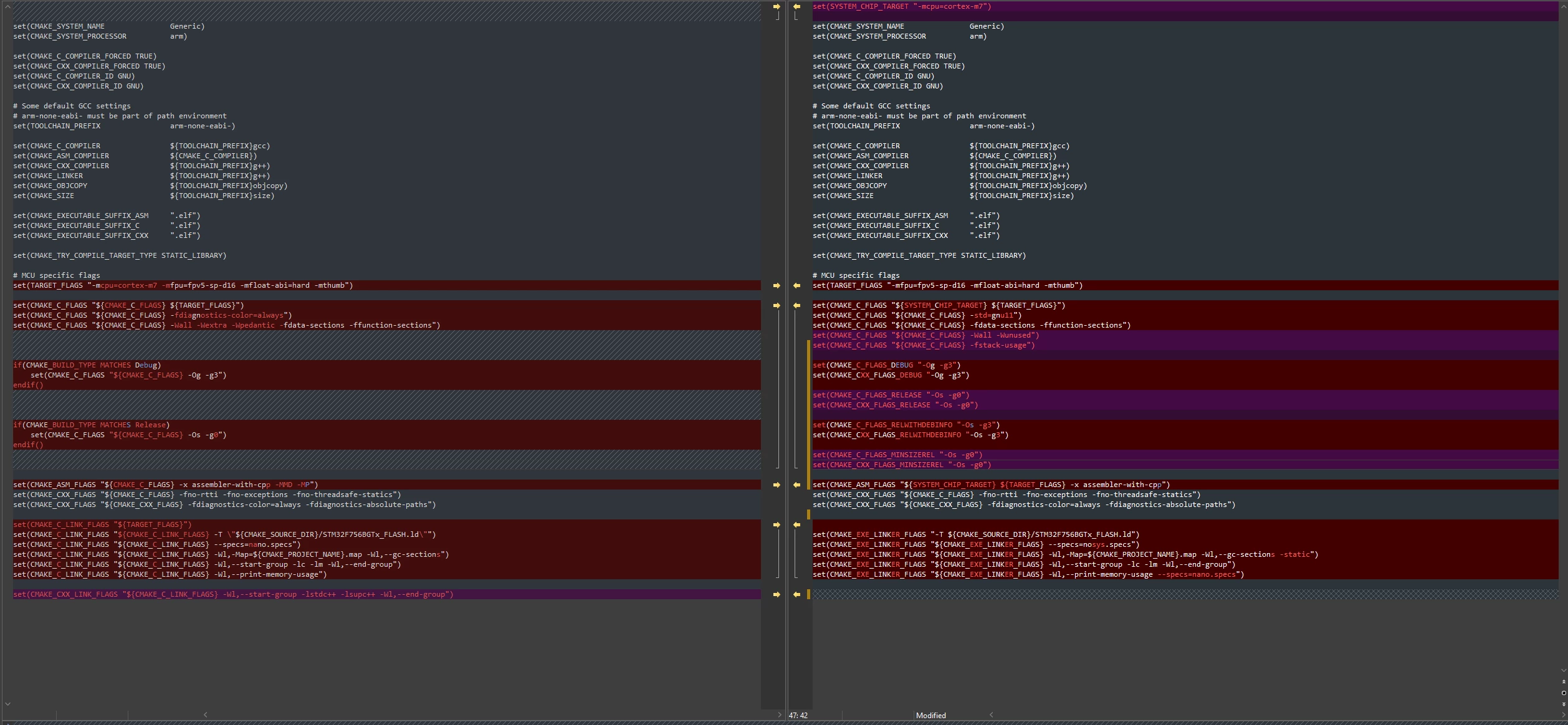

Methodology:
I ran a compilation of a project which was created in the STM32CubeIDE (non-Cmake)[this project performed as expected], and checked it against a build done with a project created from the Cmake-Generator in STM32CubeMX.
In doing this comparison, i looked at all statements for all steps (assembler, compiler, linker) and modified the .cmake file (generated by the STM32CubeMX) so that the build commands were identical to the build commands from the STM32CubeIDE project.
Here is a screenshot of a Diff between what the current CubeMX generates in the .cmake file (left) and what I believe is the more correct implementation(Right).
Issues:
CMAKE_C_FLAGS are used for both Linker AND Compiler; Flags for the Assembler should not be included here.
Optimization flags are being placed in the CMAKE_C_FLAGS depending on the CMAKE_BUILD_TYPE - Why do that when cmake provides flags for specific configurations (e.g. CMAKE_C_FLAGS_DEBUG, CMAKE_C_FLAGS_RELEASE, etc.).
Some flags are being included in build steps that don't need them - the optimization flags (e.g. -Og) does not need to be included in the Assembler --- the TARGET_FLAGS do not need to be included in the Linker.
Right now, with just `-Wall` flag, i am getting compilation warnings for MX-Generated/Supplied code - I want a way to turn off compiler warnings for just the MX-generated code (this is difficult right now since the MX-Generated cmake includes the -Wextra and -Wpedantic flags) which i cannot do unless i modify the .cmake file.
Request:
It would be awesome if the STM32CubeMx could use information from a .cproject file to populate things like optimization and other build flags.  Really this is what bothers me, since i cannot export my existing STM32CubeIde project to a CMake project and the .cproject contains much of the project-specific information.  (I realize this may be outside your area)
Please Note:  Some of these things i've mentioned may be fixable with the current cmake structure;  However I am unable to figure out how to do so.
