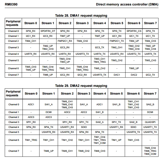

Here is a screen shot of the
http://www.st.com/content/ccc/resource/technical/document/reference_manual/4d/ed/bc/89/b5/70/40/dc/DM00135pdf/files/DM00135pdf/jcr:content/translations/en.DM00135pdf
regarding the DMA1/2 request mapping for STM32F446 MCUs :
You can see that it is not possible to configure DMA1 channel for I2S1 peripheral.
When I tried to reproduce your use case, I create first a nex project STM32F446ZEHx, then activate I2S1 in Half-Duplex master (as you did) and then go in DMA configuration, I tried to click on Add button to add a request (for DMA1) and an error message is raised ''No available DMA requests for configured peripherals''... That is compliant with the reference manual.
If I tired to activate for instance, SPI2 in full duplex, I can add a DMA1 request on SPI2_RX or SPI2_TX.
So I don't know how you added a DMA1 request on I2S peripheral, but it is not possible with CubeMX (as said in RM).
BR

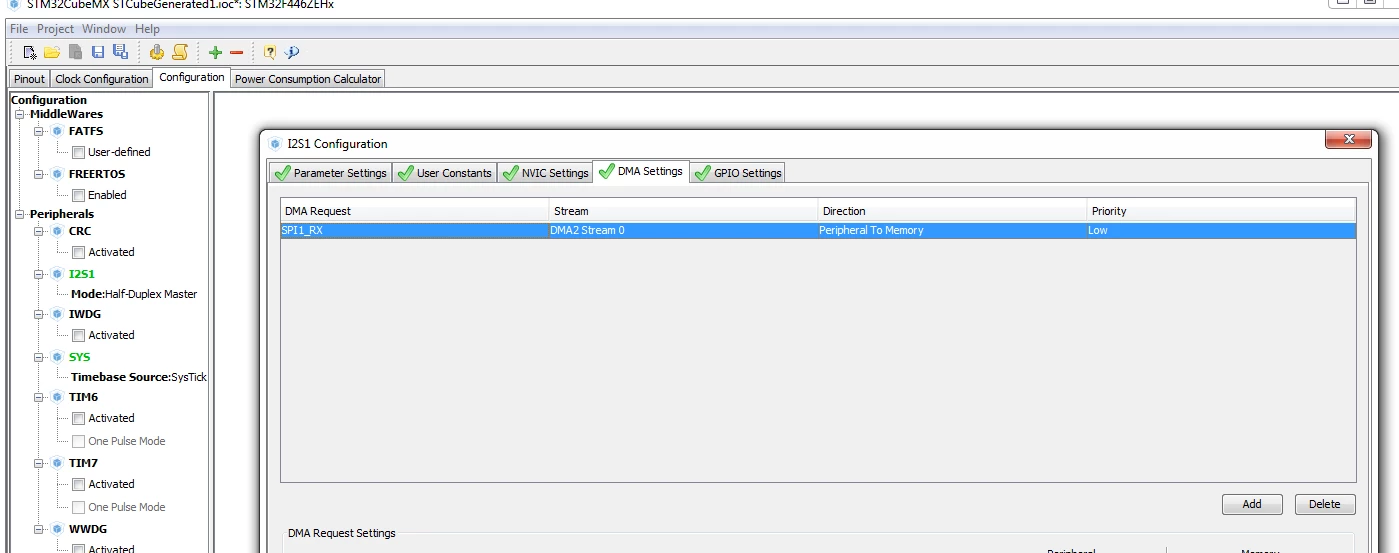

Hi
Yes, there is no option to configure DMA1 for I2S1 peripheral, DMA2 only. It is configured to DMA2 Stream 0 in the project attached to my original message:
Dma.SPI1_RX.0.Instance=DMA2_Stream0�?
Not sure, why you get this message: ''
No available DMA requests for configured peripherals''. 2 streams (Stream 0 and Stream 2) are available according to your screenshot from datasheet.I have this when configure DMA for I2S1 (I can choose DMA2_Stream0 or DMA2_Stream2):
