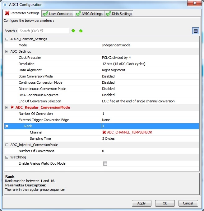

Bug: STM32CubeMX F7 V1.5.1 error when selecting ADC1->Temperature Sensor Channel
Posted on October 26, 2016 at 14:10
I updated STM32CubeMX Firmware to version 1.5.1 and opened my project (I used 'migrate' function). On 'Configuration' page now I see an issue for ADC1: ADC_CHANNEL_TEMPSENSOR is highlighted with red color. GUI says: 'Please select a new value other than Channel Temperature Sensor from the provided list. Value not found.', but there' s only one channel in the list. It looks like a bug, and the previous firmware version didn't have such an issue.

I can add to Alexey's observation that the same error happens with STM32F4 ver. 1.13.1 - both ''Channel VRefInt'' and ''Channel Temperature Sensor'' cannot be selected because of ''Value not found'' error.

This was reported when Cube 4.17.0 was released.
Cube complains about the temperature sensor and Vref, but you CAN choose them from the list and the code generated is correct.

We fully agreed that this is an issue. Thank you for reporting it.
This issue was previously seen by our development team. It is solved and will be delivered in CubeMX4.
