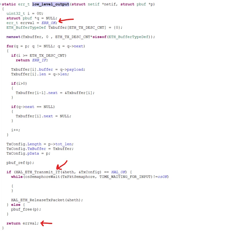

[BUG] STM32 lwIP ethernetif.c incorrect error evaluation in low_level_output()
  • April 17, 2024
  • 1 reply
  • 1296 views
When HAL_ETH_Transmit_IT() returns an error the errval variable is not changed from ERR_OK to reflect that in the else section.

Hello @Jak
Could you provide more details about the project configuration:
  • The CubeMX version used
  • The used MCU
  • If possible the ioc file to be able to reproduce the issue.
