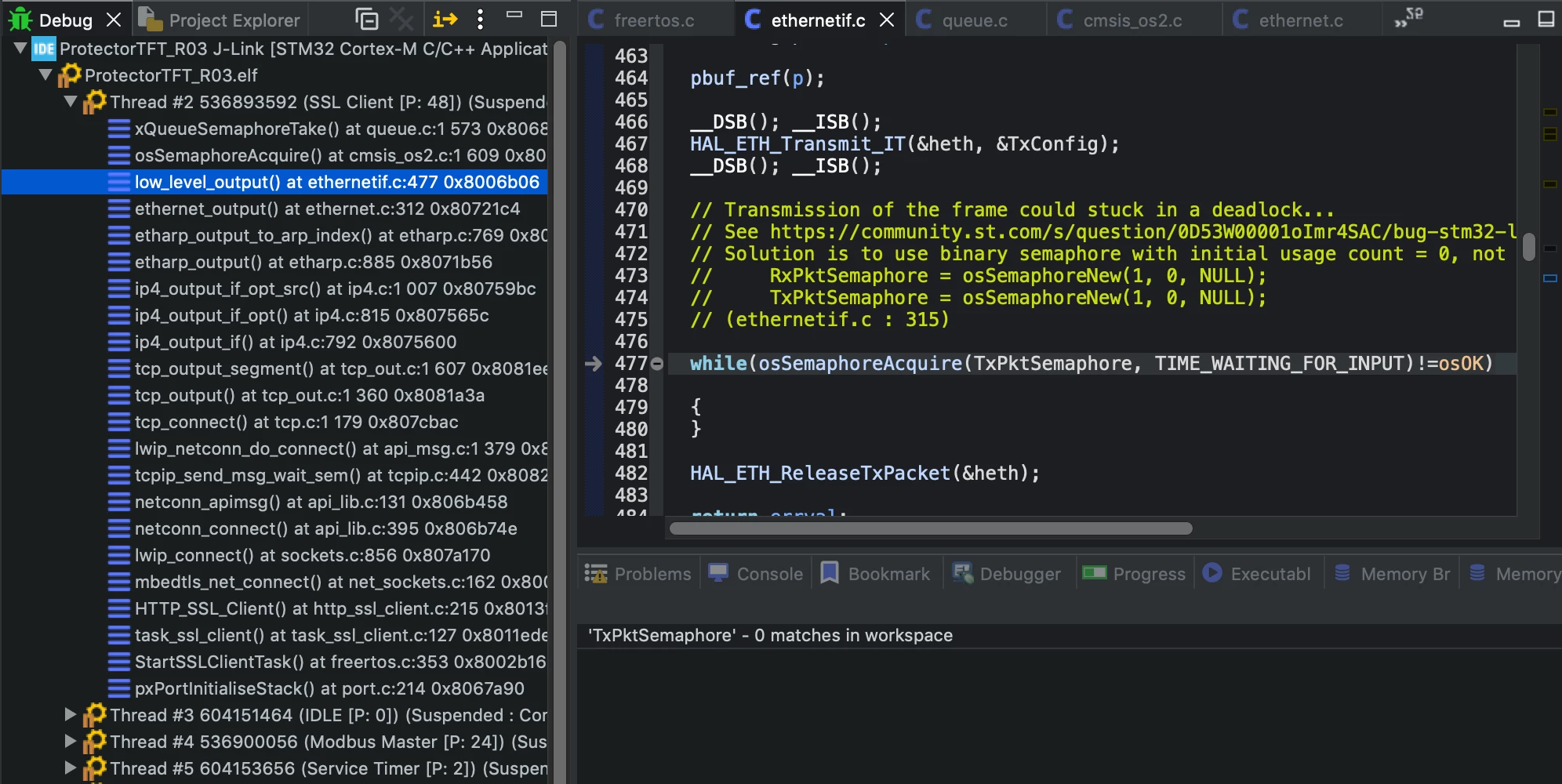

ktrofimo
Senior III
October 4, 2022
 /* create a binary semaphore used for informing ethernetif of frame transmission */
 TxPktSemaphore = osSemaphoreNew(1, 0, NULL);
void HAL_ETH_RxCpltCallback(ETH_HandleTypeDef *handlerEth)
 osSemaphoreRelease(RxPktSemaphore);
Still locks :(

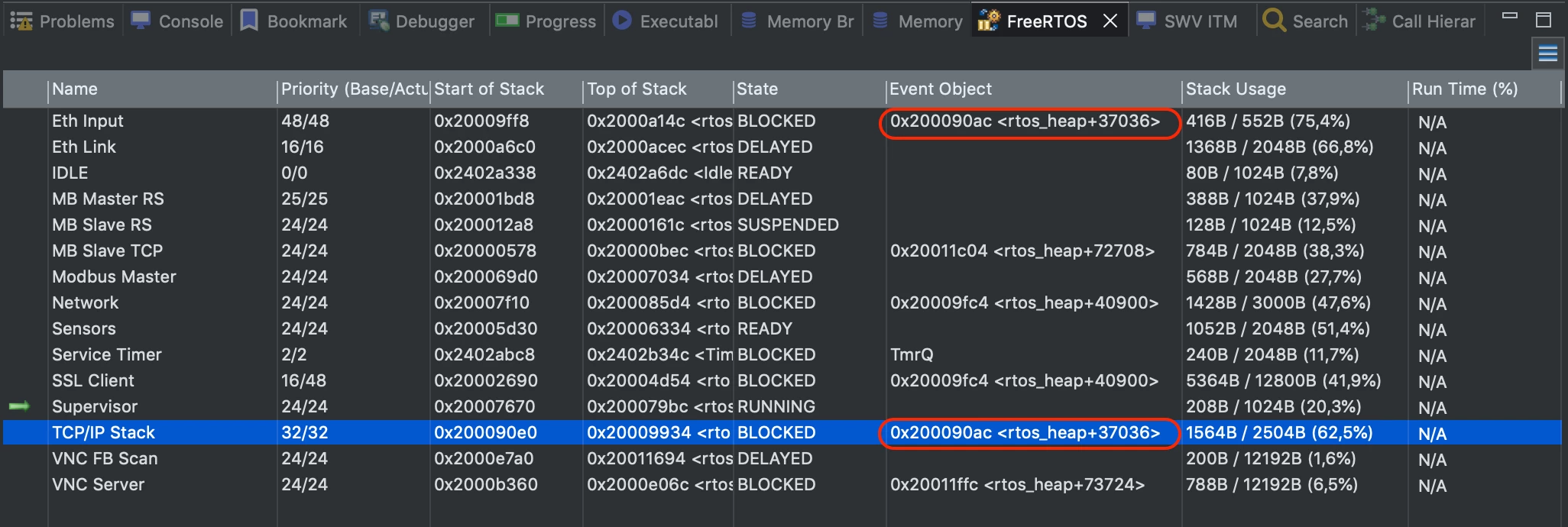

ktrofimo
Senior III
October 4, 2022
Update:
Both TCP/IP task and Eth input task both are blocked at the same event object 0x200090ac0693W00000UnKyYQAV.png
