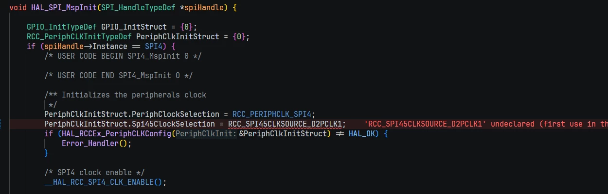

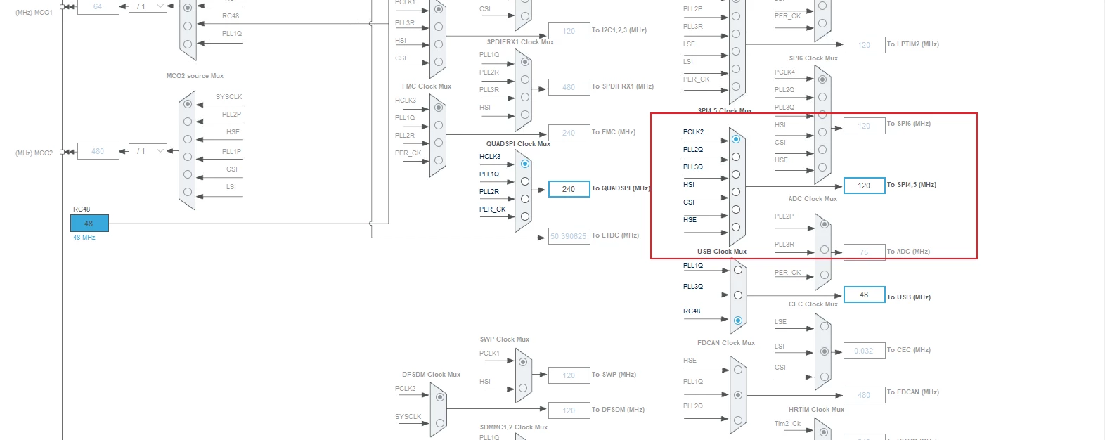

【Bug report】STM32H743VITx SPI4 clock code generation error in CubeMX
STM32H7 series MCU package version: V1.13.0
SPI4 clock is selected as PCLK2, but in the actual generated project, the SPI4 initialization function incorrectly sets RCC_SPI45CLKSOURCE_D2PCLK1 instead. The clock tree diagram and code snippet are shown below.

I reproduced the behavior described with STM32CubeMX 6.18.0, and I confirm the issue:
SPI4 initialization function incorrectly sets RCC_SPI45CLKSOURCE_D2PCLK1 instead of RCC_SPI45CLKSOURCE_D2PCLK2 .
I recommend that you change the code manually.
An internal ticket has been submitted to the development team (Internal Ticket Number: CDM0064731).
I will let you know as soon as the issue is fixed.
Thanks.
Mahmoud
