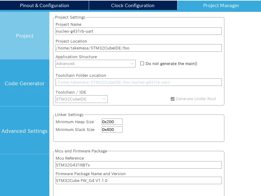

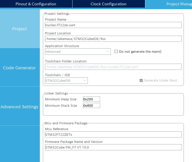

I have inserted this simple code to the main() of the CubeIDE generated code.
 /* USER CODE BEGIN 2 */
 HAL_StatusTypeDef status = HAL_UART_Transmit_DMA(
		 & huart3,
		 buf,
		 sizeof(buf));
 /* USER CODE END 2 */
It should transmit a short message through the STlink console, and then, cause interrupt. But none of these occurred.
I have checked on Nucleo F733ZE and Nucleo G431RB( 64pin ).
The demonstration program of this problem is attached as zipped. file. To see the demo of the problem.
  1. Start the tty program for the STLINK console.
  2. Include two project ( for Nucleo F722ZE and G431RB ).
  3. Build them
  4. Set break point to the interrupt handler of the DMA and UART ( stm32f7xx_it.c and stm32g4xx_it.c)
  5. Run the test program.
If the program run correctly, you will see the message on the terminal program on host, and program stop at break point on interrupt handler. I could not see these behavior.

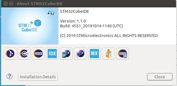

The environment is :
  • Ubuntu 16.04 LTS
  • Cube IDE 1.1.0
  • STM32Cube FW_F7 v1.15.0
  • STM32Cube FW_G4 v1.1.0
  • Nucleo F722
  • Nucleo G431 (46pin)
Please kindly check.
