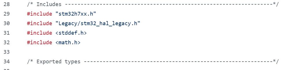

  Regarding the clock macros — I dug deeper and found the actual root cause. The include order inside stm32h7xx_hal_def.h is reversed:
// stm32h7xx_hal_def.h, line 29-30
#include "Legacy/stm32_hal_legacy.h" // processed first, but STM32H7 not defined yet
#include "stm32h7xx.h" // STM32H7 gets defined here — too late
  Since stm32h7xx_hal_def.h is first pulled in by stm32h7xx_hal_rcc.h (stm32h7xx_hal_conf.h line 246, well before stm32h7xx_hal_cortex.h at line 298), the legacy header gets processed immediately with STM32H7 still undefined. The #if defined(STM32H7) guard at stm32_hal_legacy.h line 3670 silently skips the USB FS clock macros. Once stm32h7xx.h defines STM32H7 on the very next line, the legacy header's include guard has already locked it out.
   Swapping the two lines fixes it:
#include "stm32h7xx.h"                 // define STM32H7 first
#include "Legacy/stm32_hal_legacy.h" // now #if defined(STM32H7) evaluates true
  This is separate from the GPIO AF bug and is a HAL driver-level issue. Worth a second ticket perhaps?

Hello ​@PKB404
I am sharing with you the response of our expert in the escalated  ticket #0064918
In Cube firmware, stm32h7xx_hal_def.h, the includes are already in the expected order:
This is also consistent with the GitHub reference:stm32h7xx-hal-driver/Inc/stm32h7xx_hal_def.h at 2ef1c0203b6953acb9751727ba34ce8ee7906783 · STMicroelectronics/stm32h7xx-hal-driver

  I used clang-format to improve the indentation and formatting of the CubeMX-generated code. However, include sorting was enabled, which appears to have reordered headers that depend on a specific inclusion order, causing compilation errors.
  I fixed the issue by restoring the required include order and disabling include sorting in .clang-format, so future formatting preserves that order.
