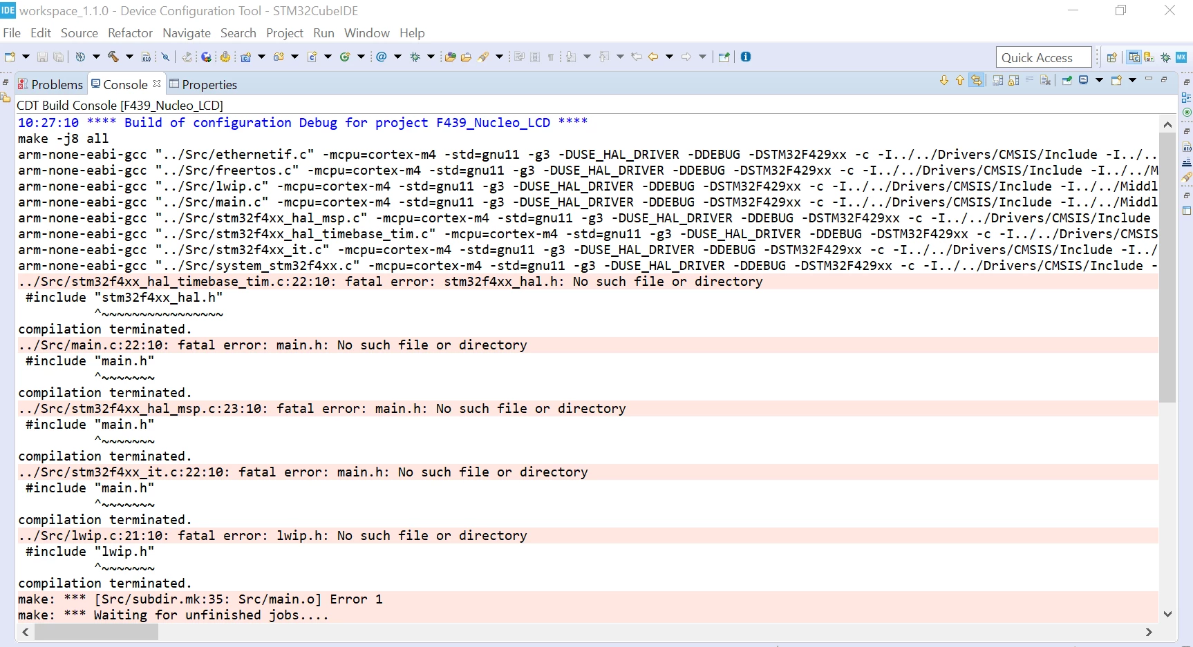

Bug: IOC generates code that does not compile
  • October 31, 2019
  • 9 replies
  • 3428 views
Update: Complete bad generated project attached, picture of build failure added.
Note this problem is produced with the CubeMX plug-in inside the IDE, not the stand-alone CubeMX.
F439, latest CubeIDE, included RubeMX 5.4.0, and HAL/LL stuff all downloaded in last couple days.
Attached IOC generates code with many bugs:
  1. Does not compile. Completely hopelessly wrong include paths.
  2. Include paths are generated trying to guess number of "../" required by source in multiple directory depths, and getting it wrong.
  3. Generated include paths should be workspace/project relative but are not
  4. No less than 3 copies of cmsis_os.h are generated, etc, etc.
  5. Multiple copies of 3rd party middleware sources (for both lwip and freertos) are emitted, for example under both Middlewares\FreeRTOS and Middlewares\Middlewares\Third_Party\FreeRTOS, with differing directory structures!!!
This is absolutely, absurdly, and completely broken.
Has anybody ever tested any of this software?
STM, Please confirm you have reproduced the above problems and filed at least 150 tickets,
Thanks,
Best Regards, Dave

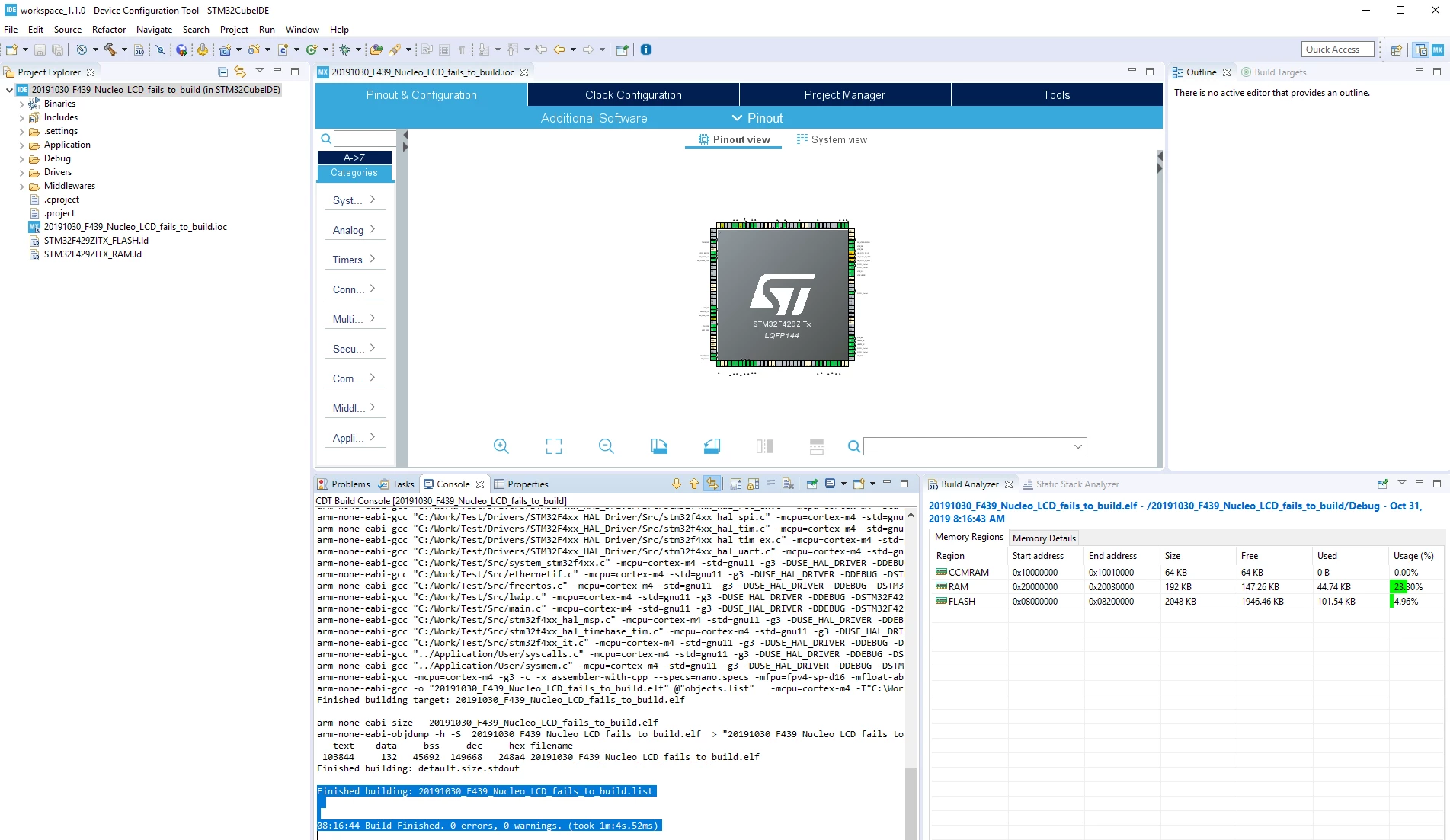

Dave,
I'm pleased to say relying on your shared .ioc file all is just working nice. I've got a try relying on latest STM released material (MX 5.4.0 & CubeIDE 1.1.0 pair).
1) I've generated CubeIDE project starting from CubeMX (just doing "File>Load" then "Generate Code")
2) I've imported then such project within CubeIDE
3) I've just build it …. leading to compile process success !!!
Process sounds to me quite obvious & functional.
More details about your usage …. may help to dig into issue you may face … then maybe STM may have some ticket to log
Br.

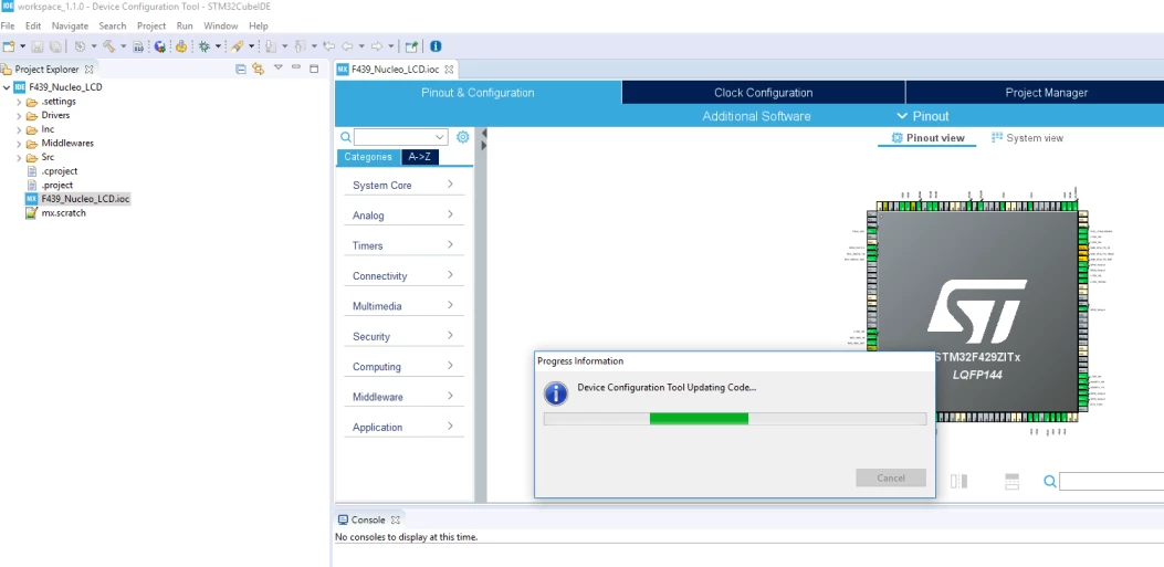

Dave,
Yes I've used CubeMX standalone to get success playing with your .ioc file.
Trick is according your file content no choice … CubeIDE is not able to generate a project from because some specific project mode requirement Inside.
Your project once generated will be fully supported by CubeIDE but CubeIDE not able to generate it by itself.
Magic parameter within your .ioc fiel is : ProjectManager.UnderRoot=false
If you really want to rely only on CubeIDE and if such parameter is not so important to you please have try to hack your .ioc file doing: ProjectManager.UnderRoot=true
Now let's play with CubeIDE ONLY:
1) Create a brand new common Eclipse project/ File > New Project then General Project type
2) Mandatory to set as project name the same you have within your .ioc file (not your .ioc file name … takes care): F439_Nucleo_LCD
3) Let's copy your .ioc file within such project setting same file name as your project name: F439_Nucleo_LCD.ioc
4) Double click on such .ioc file … .ioc editor should open
5) Let's request code generation then ...
6) You're done … let's compile …. on my side leading back to compile success
Enjoy !
