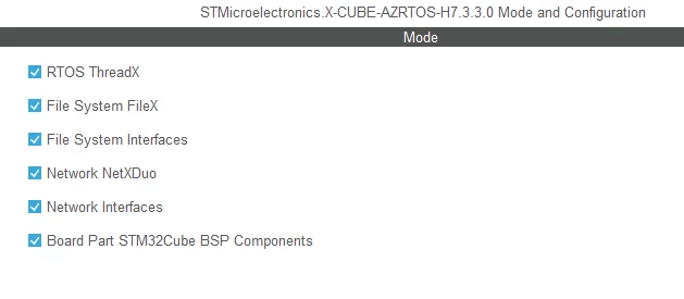

Hello STM-Team,
I'm working on my project with an STM32H723ZG and ran into an issue with the code generation when I selected "Network Interfaces" in the  AZRTOS configuration.
The code generation will add "NX_ETH_INTERFACE_ENABLED" to the "RTE_Components.h" but forget the "#define" in front of it.
That is somewhat annoying because I have to manually add this everytime I regenerate the code.

Hello @Intector
Thank you so much for sharing this input. I'm able to reproduce this behavior and I've escalated for correction on the coming releases (under internal ticket number 197441).
