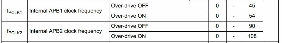

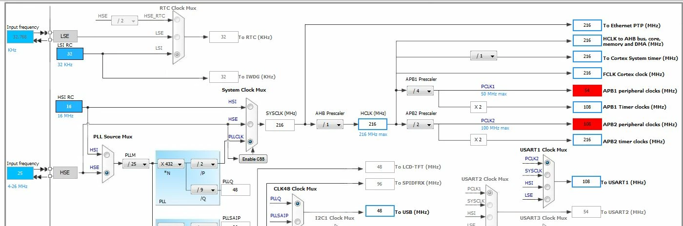

Experiment Set-up:
STM32CubeMX version: 4.11.0
STM32F746NGH6
Description:
It limits the PCLK1 to 50 MHz and PCLK2 to 100 MHz. See the RED error below:
However, The PCLK1 can reach 54 MHz and PCLK2 can reach 108 MHz after over-drive.

Hi zhong.wenbin.001,
Thank you for your feedback. The issue has been reported internally.

Dear user,
Thank you for reporting this issue. It will be solved in STM32CubeMX release 4.12.0.
