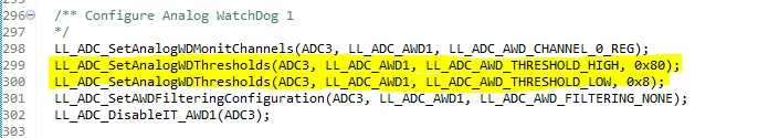

Hello @magnus Kristiansen-Modéer​ ,
Concerning the issue related to STM32CubeMx and reported in 143921 ticket is fixed in STM32CubeMX.6.8.0 and the LL_ADC_SetAnalogWDThresholds is changed by these correct code lines:
_legacyfs_online_stmicro_images_0693W00000biDdgQAE.pngI tested this by enabling analog watchdog 1 for ADC3 on a Nucleo-H723ZC in STM32CubeMX6.8.0 with low threshold 0x8 and high threshold 0x80 and I used STM32CubeIDE1.12.0 toolchain to generate the code.
Please let me know if the STM32CubeMx issue is solved!
Kaouthar
mkm_ctv
mkm_ctvAuthor
April 17, 2023
Sorry, I missed that. The generated code is indeed correct now but the code called (in "STM32Cube FW_H7 V1.11.0") seems to still be faulty.
