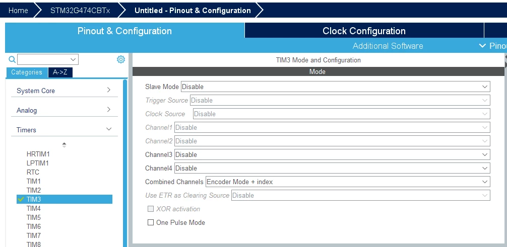

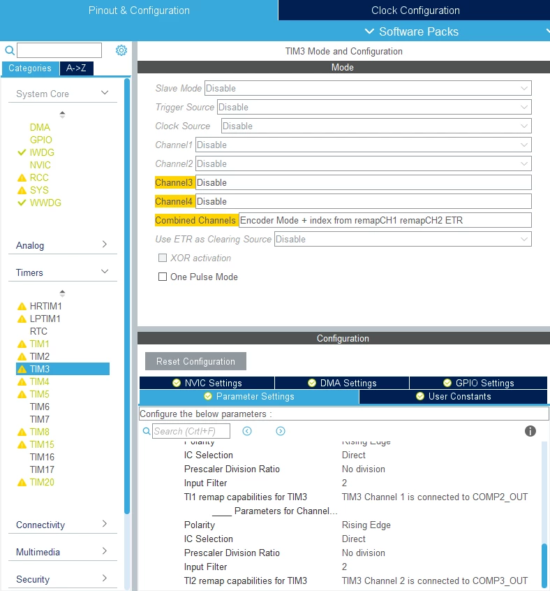

I'd like to report a bug in code generation of CubeMX when using encoder mode with remapping of CH1 and CH2 and LL drivers. I use STM32CubeIDE v1.4.1 and STM32G474.
The problem is that the commands to configure the remapping of TI1 and TI2 are split into two calls to "LL_TIM_SetRemap" (example for TIM3):
LL_TIM_SetRemap(TIM3, LL_TIM_TIM3_TI1_RMP_COMP2);
LL_TIM_SetRemap(TIM3, LL_TIM_TIM3_TI2_RMP_COMP3);
The second call to "LL_TIM_SetRemap" erases the setting in the first command (since it uses "MODIFY_REG" under the hood, clearing all remap bits by default).
The correct code would be combining the settings in a single command like so:
LL_TIM_SetRemap(TIM3, LL_TIM_TIM3_TI1_RMP_COMP2 | LL_TIM_TIM3_TI2_RMP_COMP3);
A screenshot of CubeMX configuration example is attached.

Sometimes you folks are really lazy ;) Just set the settings in the screenshot and you're done. For your convenience I attached an .ioc .
My CubeMX version is 6.0.0.202007160824
