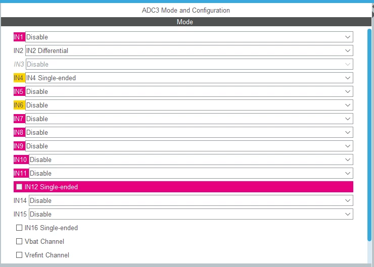

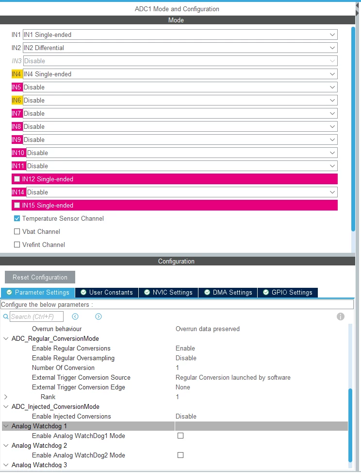

I have tested it with following setup for ADC1 and ADC3. By ADC-3 it is more surprising that i have configured Channel 2 to be differential and channel 4 to be single ended and the generated code configures randomly channel  4 only. All other configured channels are completely missing in code.
Cube configuration for ADC1:
Generated Code by CubeMX:

Cube configuration for ADC 3:
Generated code in main.c:

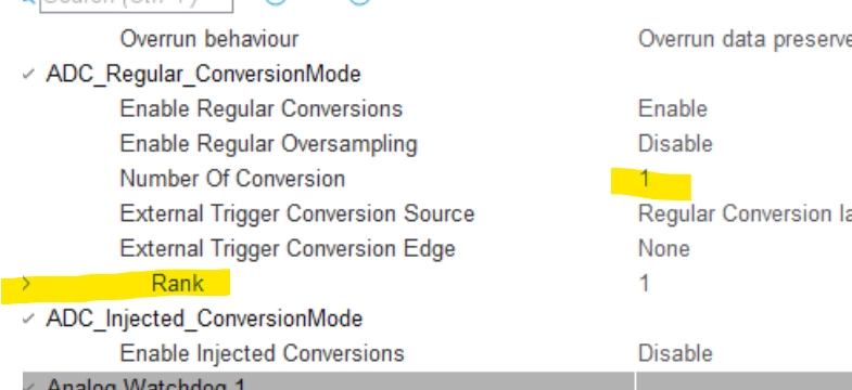

You only have one channel conversion selected. Increase that to the number of channels you want to convert.
Then, expand Rank and select the order and configuration of each converted channel.

Hi thanks for the quick response.
Why do i have to change the Number of conversion when i have enabled the channels by selecting the conversion mode from "disabled" to other mode. I hadn't expected to have to do it. When i have configured the  channels from "disabled" to specific mode i think the software should configure it.
Thats why i had expected that Cube will configure them. When it is for some purpose hardly required to set Number Of Conversion to "enable" the configuration of selected channels it is confusing to change channels from "disabled" to some mode.
July 25, 2024
Because that's how the program works. It can't read your mind, you have to follow the rules. I didn't write it.
Perhaps it should add new channels as you enable them, but it doesn't, so you have to do this.
