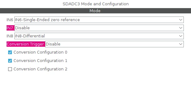

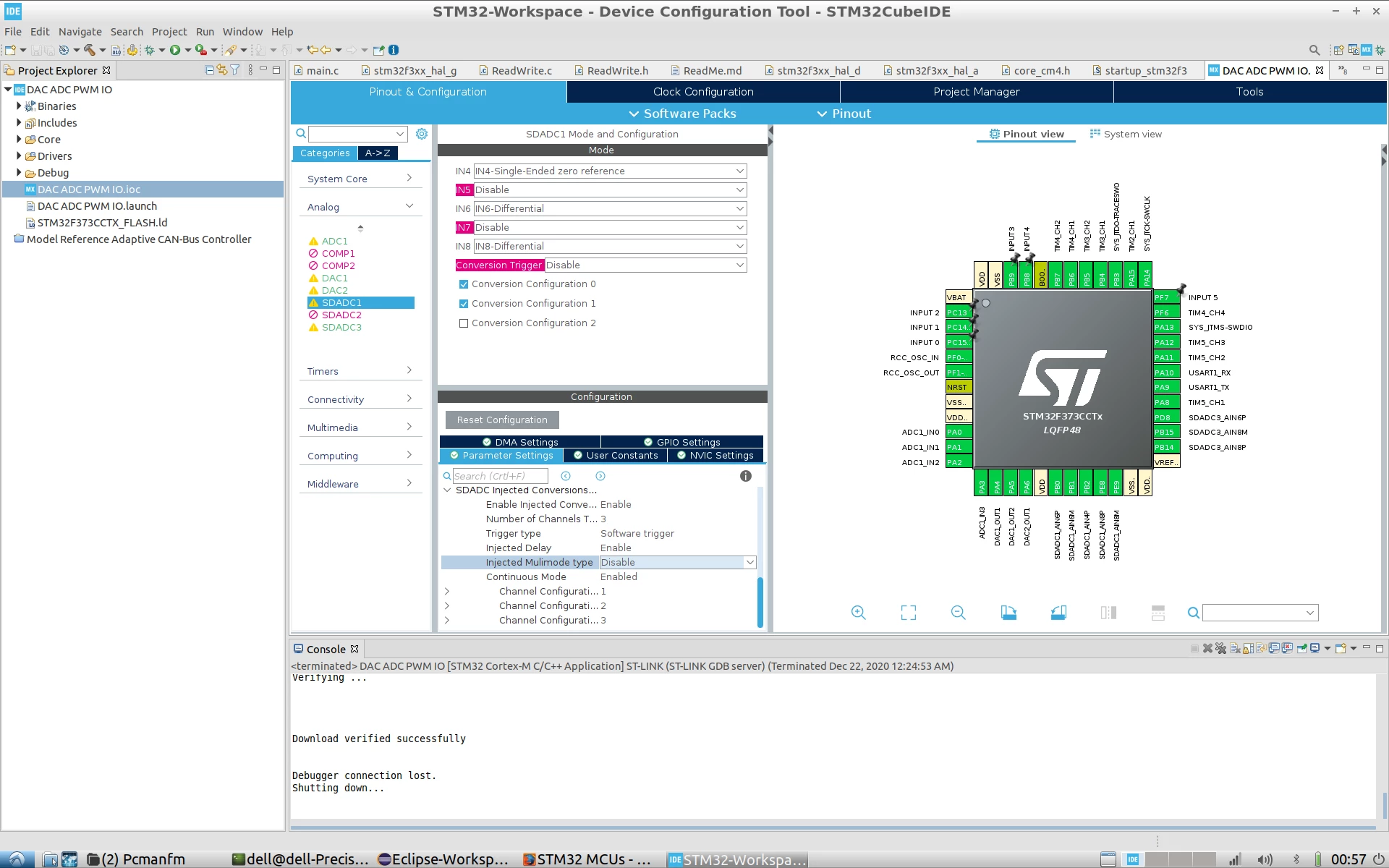

BUG Found: Cannot have Multi mode on STM32F373
Hi!
I want to report a bug.
I tried SDADC and I found a bug.
Also it should stand "Multi mode" not "Mulimode" and the STM32CubeIDE 1.5.0 (I'm using) missing calibration options in the STM32CubeIDE project starter.
To solve this issue. Write this code inside the "SDADC_init()" function
// Multi mode for SDADC1 and SDADC3
if (HAL_SDADC_InjectedMultiModeConfigChannel(&hsdadc1, SDADC_MULTIMODE_SDADC1_SDADC3) != HAL_OK)
	Error_Handler();

Also for using multiple interrupts for the SDADC (In this case SDADC1 and SDADC3). Please use this code as callback function for the NVIC interrupt. Here i have 3 inputs from SDADC1 and 2 inputs from SDADC3.

Screenshot of the bug:

Hi @Daniel Mårtensson​ ,
Thank you for your feedback.
Could you please share your .ioc file.
What I understand that the bug is "Mulimode" should be "Multi mode", is that right ?
Could you add more details.
Thanks again
Houssem
DMårtAuthor
Lead
Dec 22, 2020 1:52 PM UTC
As you can see in the picture above, I cannot select "Mulimode" because it's disabled. It should not be disabled. It should be an option to select SDADC3 from SDADC1. Therefore, I had to add this manually. Also "Mulimode" is spelled wrong.

Dec 22, 2020 2:24 PM UTC
Thank you for your feedback,
This is reported internally and it will be fixed as soon as possible.
