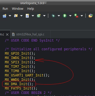

[BUG] D.T.C.C.G. produces MX_DMA_Init in wrong position? (USART/SPI - STM32CubeIDE 1.9.0)
  • May 27, 2022
  • 4 replies
  • 2193 views
"A regression was detected in the previous STM32CubeMX version 6.3.0 (STM32CubeIDE Version: 1.7.0 ) generating a wrong order of initialization functions.
This issue was fixed in the latest STM32CubeMX version 6.4.0. Thus, newly created project with this version will generate the correct initialization functions order."
https://community.st.com/s/question/0D53W00001EzCmCSAV/mxdmainit-order-in-the-mainc-file-generated-by-stm32cubemx-how-to-fix?t=1653614837707
"And then called these initialization functions manually in the following user code segment, and now it looks like this"
https://stackoverflow.com/questions/70558087/stm32-spi-ll-dma-transmit
"I couldn't solve it without solving the same problem. But this solution really works. I can't understand why CubeMX is generating wrong code."
https://community.st.com/s/question/0D50X0000AxEm8USQS/solved-spi-dma-doesnt-transmit-anything-is-my-configuration-wrong
Best answer by Sara BEN HADJ YAHYA
hello @rtek1000​ ,
Thanks for your feedback,
This is a known issue and it will be fixed soon, for more details please check my answer in this thread.
Sara.

hello @rtek1000​ ,
Sara.

June 29, 2022
Hello @rtek1000​ ,
This issue is fixed in STM32CubeMX latest release.
V6.6.0 is now available under this Link.
Thanks for your contribution.
