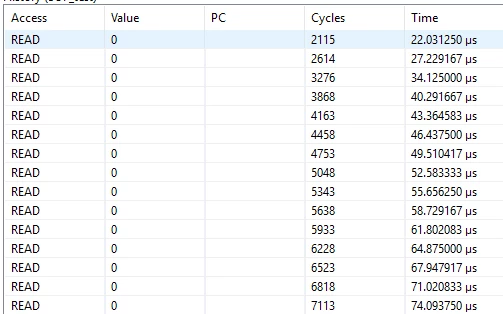

It only happens when there's an active transfer.
The OTG interrupt was called every 3...6uS (300-500 Core clocks @ 96MHz).
It seemed crazy excesive to me, that can't be correct!
Just to clarify: STM32F411, internal FS controller, cubeIde initialization, host mode (OTG).
Checking what interrupt flag was causing the calls, I found the culprit to be the SOF flag.
I put a small variable there and traced using SVW:
I have SOF disabled in CubeMX, however the code enables it anyway:
IDE: STM32Cube IDE v1.6.0
FILE: stm32f4xx_ll_usb.c
LINE: 1355
FUNCTION: HAL_StatusTypeDef USB_HostInit(USB_OTG_GlobalTypeDef *USBx, USB_OTG_CfgTypeDef cfg)
 USBx->GINTMSK |= (USB_OTG_GINTMSK_PRTIM | USB_OTG_GINTMSK_HCIM | \
 USB_OTG_GINTMSK_SOFM | USB_OTG_GINTSTS_DISCINT | \
 USB_OTG_GINTMSK_PXFRM_IISOOXFRM | USB_OTG_GINTMSK_WUIM);
Removing USB_OTG_GINTMSK_SOFM from the mask fixed the problem.
I'm still having interrupts every 40uS (around 3000 cpu cycles) caused by the USB_OTG_GINTSTS_RXFLVL flag.
Edit: That's correct, due the 64-byte buffer triggering the FIFO interrupt
(64 bytes = 512 bits, at USB 12MHz clock = 42uS).
However it still has does some 3-5uS ones. Not a thousand, but maybe 10 out of 20.
Maybe the interrupt is not being fast enough ?

If you have SOF interrupt more often than once in a frame (maybe microframe in HS, I don't use HS), then it's likely you've set the frame timer (OTG_HFIR) incorrectly. Observe, how fast frame number in OTG_HFNUM increments, and observe the SOF frames on the bus.

OTG, so Host mode. Internal FS controller.
Default CubeMx configuration.
I might be a debugging issue, as it seems to happen a lot more when you halt the core, I guess the USB keeps working in the background, the interrupts pile up, and when you resume it's like a tsunami.
