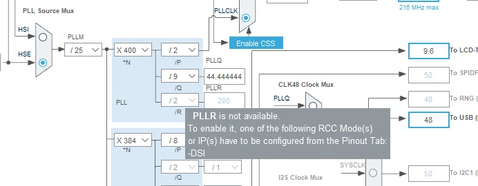

BUG: CubeMX STM32F767IG RCC Assert Failed
  • January 24, 2020
  • 4 replies
  • 862 views
CubeMX 5.5.0
STM32Cube_FW_F7_V1.15.0
STM32F767IG
Assert Failed: FILE - ../Drivers/STM32F7xx_HAL_Driver/Src/stm32f7xx_hal_rcc.c, LINE - 602
RCC_OscInitStruct.PLL.PLLR is not assigned a value, therefore = 0, which fails above assert
Adding following code resolves issue
/* CUBEMX BUG FIX
 * PLLR not initialized to a valid value
 * PLLR >=2 && <= 7
 * Initialize to 2 (reset value)
RCC_OscInitStruct.PLL.PLLR = 2;

Could you please send me your .ioc file to check the issue .

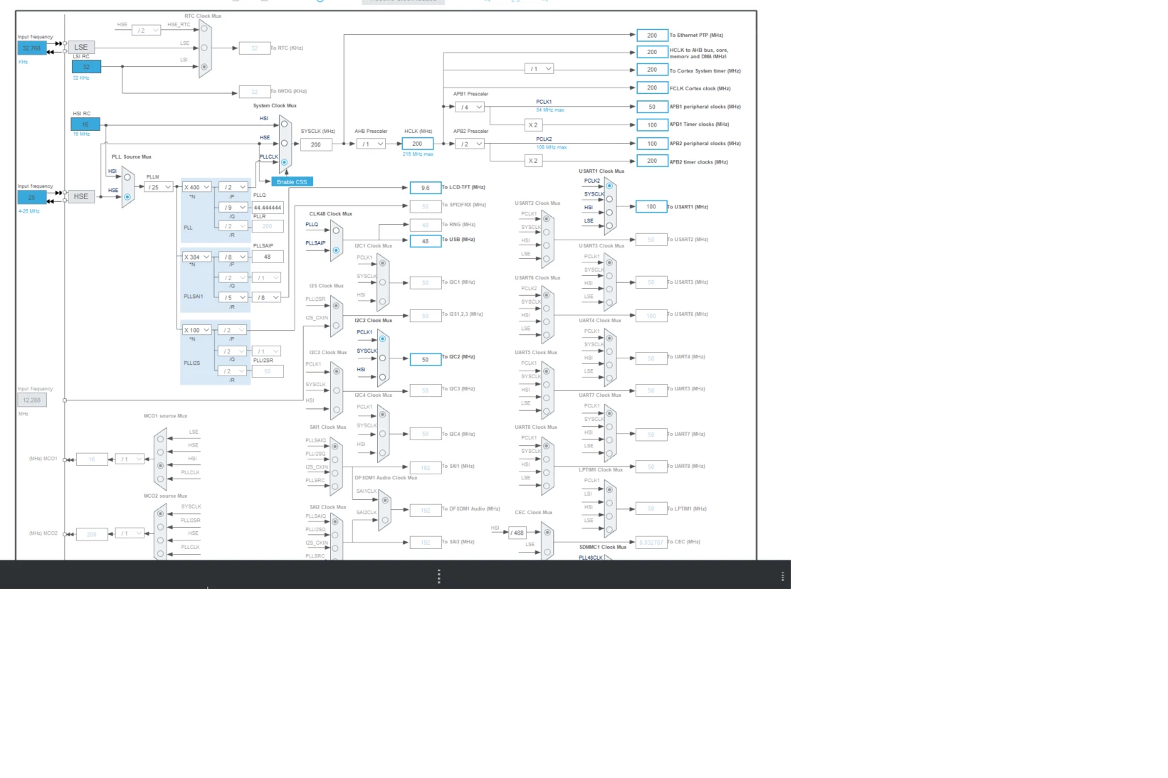

Here is the .ioc file.
Also forgot to mention that in the Clock Configuration the drop down for the R prescaler in the PLL block is greyed out.0690X00000BwYNnQAN.png

You have to check if it's being used by a device. If not, it should be grayed out.

February 3, 2020
Correct, it should be greyed out on this device as it doesn’t have DSI, but the clock config code that it generates still fails an assert without a way for the user to change it every time the code is regenerated.
