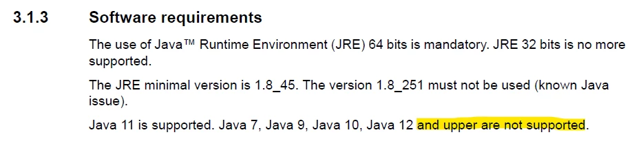

Bug: CubeMX STM32F4 Keil project generation does not work with Java 14, where it works with Java 11
I have a project that generates fine using CubeMX 6.0.1 STM32F4 1.25.1
Now I upgraded to Java 14.
The project generation has problems on the Keil Project file generation.
When I go back to Java 8 it works.
Same problem on ST32F4 1.25
Please ST fix this bug.

Hi @taraben​ ,
We are aware of such issue with Java 14 and we mention it in STM32CubeMX User Manuel UM1718.pdf, see below:
But we are working harder to fix the issue in the coming MX version.
I suggest you to go back to another JRE version (e.g Java 11 or Java 8).
Thanks for your comprehension.
