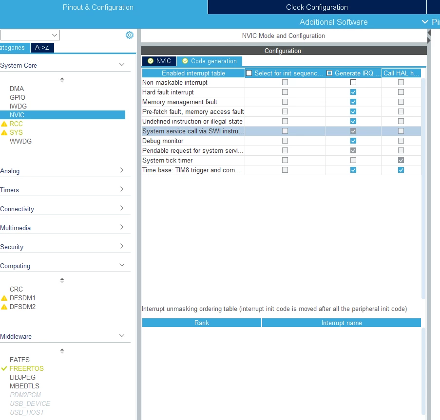

BUG: CubeMX generates erroneous SVC and PendSV handlers with FreeRTOS
CubeMX selects and will not disable code generation for SVC and PendSV interrupts.
The generated empty ISR handlers in stm32f4xx_it.c conflict with FreeRTOS handlers:
IOC is attached. This did not happen in other projects.

I too battled with this problem! It has not been fixed as of latest version. Here is my workaround for anyone else having this problem. At the top of your stm32xxxx_it.c file, add the following to effectively rename the auto generated functions. Then you can use the FreeRTOS defined ones in their place. It also will prevent STM32CubeMX replacing them on every code generation.
Even worse, is if you call the FreeRTOS pendSVHandler from inside the auto generated interrupts, you get stack corruption as FreeRTOS expects these handler to be called directly without wrapper functions that push onto the stack!
/* Private define ------------------------------------------------------------*/
/* USER CODE BEGIN PD */
void UnusedHandler1(void);
void UnusedHandler2(void);
#define PendSV_Handler UnusedHandler1
#define SVC_Handler UnusedHandler2

@Nesrine.JLASSI​ , @Amel NASRI​ , @Camilo LEMOS​ - It is absolutely appalling that this is still not fixed after more than 6 months!
I just regenerated code using the attached IOC using CubeMX IDE 1.3, FW_F4 V1.24.2, and
it is still producing bogus non-weak SVC and PendSV handlers!
For heavens sake, get this fixed already!!
Really now!!!
