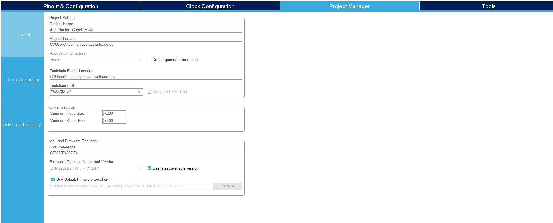

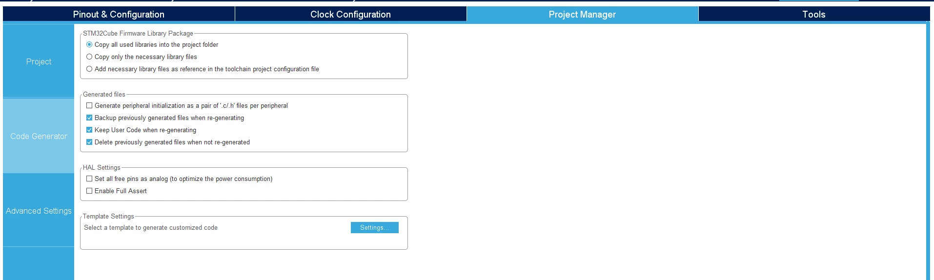

Hi @Dave Nadler​
Thanks for the feedback.
You are right, i was able to reproduce the issue and it will be fixed in the next STM32CubeMX release.
Now, to solve the problem, you can use EWARM as Toolchain/IDE
0690X000009YF0jQAG.pngNext, select please "Copy all used library into the project folder".0690X000009YF0KQAW.png
Then, generate the code.
==> No issue
