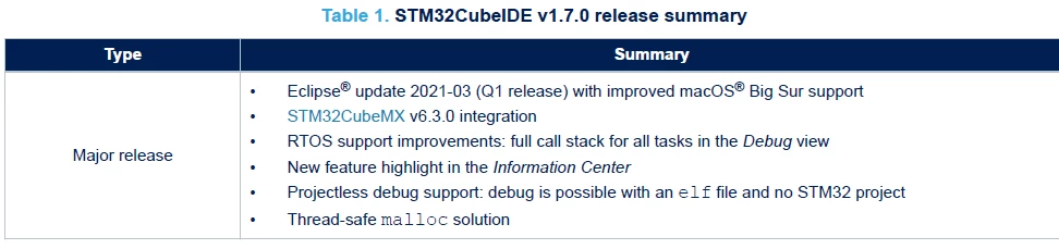

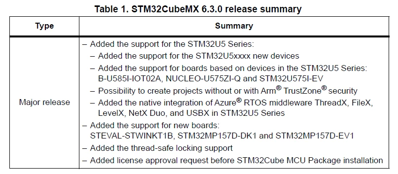

Hello again,
Looks like STM has released a fix for this in the latest STM32Cube IDE 1.7.0 / CubeMX 6.3.0 release according to their release notes:
0693W00000D096uQAB.png0693W00000D09A7QAJ.pngI haven't tested this or investigated the fix, but figured I would update this thread to raise awareness. Note that if my memory serves me correctly, STM released a fix in the past that didn't work. So before anyone deems this a working fix, I would investigate yourself or wait for peer verification. @Dave Nadler​  in case you are curious.

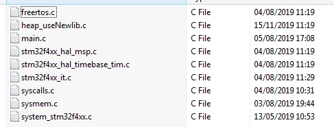

As I wrote above, the newlib printf and heap lib which comes with ST Cube IDE (and thus gets generated by Cube MX) is stuff from 1990 and it has been built badly, with mutex protection in the right place but with the mutex calls being empty stubs. This can be fixed but not completely trivially because libc.a (where all this stuff lives) was compiled without the symbols being "weak".
That link to Dave Nadler's site is a zipfile containing the following
_legacyfs_online_stmicro_images_0693W00000dDUrCQAW.pngwhich I cannot understand the relevance of. Most/all of those files have no relevance to this problem.
