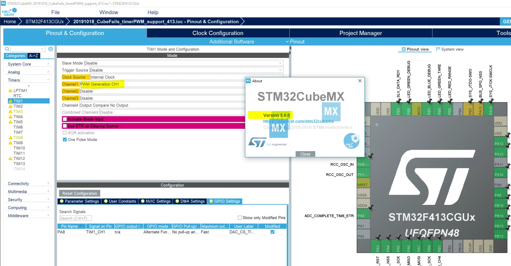

BUG: CubeMX fails to support timer PWM modes
- 4 replies
- 891 views
Note: This is still broken in RubeMX 5.4.0
Note: I am using the CubeMX plug-in within the STM32CubeIDE, not the stand-alone CubeMX.
RubeMX shows only 5 of 7 possible timer channel modes. It fails to show PWM modes. Attached IOC shows problem (try to set PWM mode for timer 1 or timer 3).
STM32CubeIDE Version: 1.1.0
Build: 4551_20191014-1140 (UTC)
OS: Windows 10, v.10.0, x86_64 / win32
Java version: 1.8.0_202
Please confirm you have reproduced this and filed a ticket...
