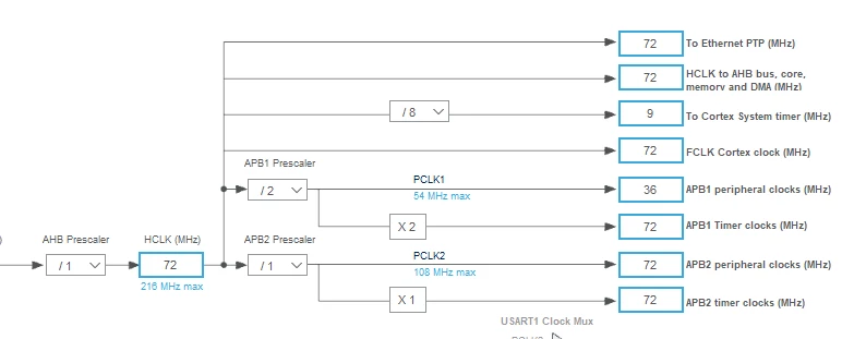

When set divider by 8 for cortex system timer, Cube doesn't generate properly code like below:
HAL_SYSTICK_CLKSourceConfig(SYSTICK_CLKSOURCE_HCLK_DIV8)

Thank you for having reported.
I assume this is the exact same issue already reported to the development team and tracked by the Ticket 154936 and that will be fixed as soon as possible.
