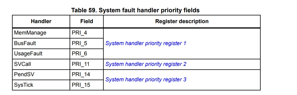

BUG: CubeMX allow to set priority for DebugMonitor_IRQn but programing manual NOT
In document programmin manual, PM0253,  SHPR1-3 registers allow to set priority for following handlers:

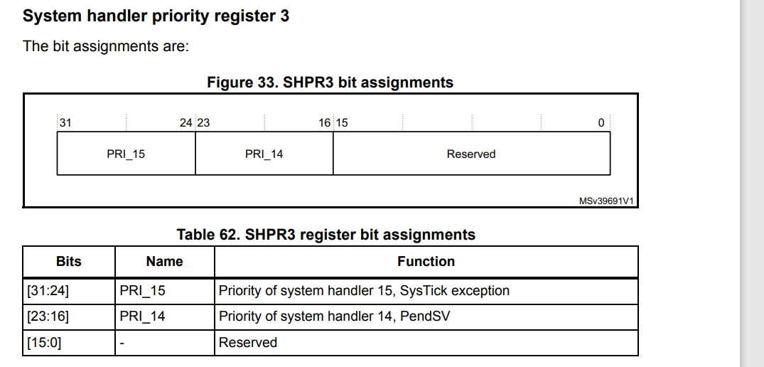

but Debug monitor writes to reserved field PRI_12:
The same ambigious is in Cortex M4 and perhaps in all

Hello @Kamil Duljas ,
The PM0253 is aligned with Arm Cortex-M7 Devices Generic User Guide r1p2 description, but we got confirmation, you can use PRI_12 to set of the priority of debug monitor for Cortex-M7, Cortex-M4, Cortex-M3 and Cortex-M33.
