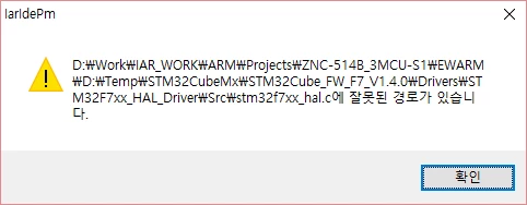

I used STM32CubeMX with 4.16.0 or 4.16.1 version.
below situation :
''STM32Cube Firmware Library Package'' option is ''Add necessary library files as reference in the toolchain project configuration file''
IAR's error message is all same below
Fatal Error[Pe1696]: cannot open source file ''D:\Work\IAR_WORK\ARM\Projects\ZNC-514B_3MCU-S1\EWARM\D:\Temp\
STM32CubeMx\STM32Cube_FW_F7_V1.4.0\Middlewares\Third_Party\FreeRTOS\Source\timers.c''
So, IAR cannot find Driver files(HAL_Driver's files)
Because included wrong path for Driver files.
- �Toolchain Folder Location� is
Repository Folder
� is
D:\Temp\STM32CubeMx\STM32Cube_FW_F7_V1.4.0\Middlewares\Third_Party\FreeRTOS\Source\timers.c0690X00000604maQAA.png
Why combined file path in generation code?

Which version of IAR is used ?
I have see this case which due to long path !
Try to share your .ioc to report this case and identify what is going wrong.

I'm using cubeMx 4.16 and now 4.17 and have a similar problem with the cubeMX code generator. The code generator updates the IAR project files in a wrong manner as shown below.
<file> <name>
$PROJ_DIR$\D:\
SVNRoot\Drive3Ph_F4\Plus\stmCubeRepos\STM32Cube_FW_F1_V1.4.0\Drivers\CMSIS\Device\ST\STM32F1xx\Source\Templates\system_stm32f1xx.c</name>
</file> This error is very annoying

I still have the same problem with the corrupt path entries in the IAR project file *.ewp.
I've found that the problem has to do with relative paths in the IAR project settings.
cubeMX always generates code with absolute path entries in the project file and gets a mess when there are relative paths in the IAR project file to update during code generation phase.
Is someone there who can help?
Regards AB

One month has now passed without STM assuming the problem. This is annoying, because I have to edit the project file after every Code generation within cubeMX!
Here some hints for the ST team:
I think that the cause for the problem is that IAR uses relative paths and the cubeMX code generator uses absolute paths.
- cubeMX generates duplicated entries in the *.ewp project file (leaves the relative entries of IAR and creates new absolute entries).
- It seems that in the case that cubeMX (C:) and the project (D:) are in different drives, doubling through cubeMX will generate wrong paths (with $PROJ_DIR$/\D:\...) causing the problem.
- if cubeMX and the project are on the same drive (C:), cubeMX still doubles entries in the project file but with correct absolute paths and IAR can handle this situation.
Regards AB

Dear user,
This issue is fixed in the release 4.18 coming out in the next few weeks.
Best regards

I have just checkd with the new cubeMX 4.18.
The problem seems to be solved.
