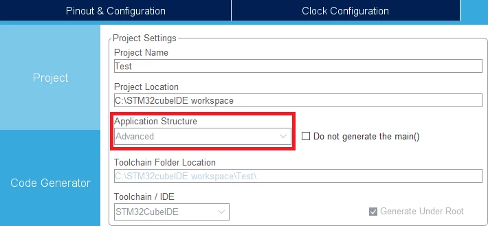

BUG: Application Structure cannot be changed
It's not possible to change the application structure in STM32CubeIDE v1.1.0.
STM32CubeMX v5.4.0 is installed.
The option "Advanced" is always used on every new created projects.

​Hello @AScha.381​ ,
Could you please share your ioc file ?
Thanks,
Khouloud.

​You're right @AScha.381​ , Issue will be fixed in the next release.
Thanks for bringing this bug to our attention .

​for the moment you can start your project from  CubeMX 5.4.0 and set the basic advanced settings , then generate code with Toolchain CubeIDE.
Best Regards,
Khouloud.

This bug is not fixed yet. This option is just removed from the Code Generator page...
