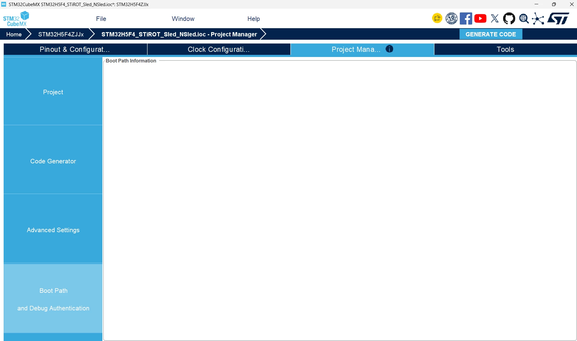

Dear ST Team,
I am following the STM32 wiki guide:
https://wiki.st.com/stm32mcu/wiki/Security:How_to_start_with_STM32CubeMX_STiRoT_Boot_path_on_STM32H57
While working through the steps, I encountered an issue with STM32CubeMX.
The Boot Path and Debug Authentication configuration pages are blank and do not display the expected options shown in the tutorial. Because of this, I am unable to continue.
STM32CubeMX Version: 6.18.1
Could you please advise how to resolve this issue?
Thank you for your support.
Best regards
RJ

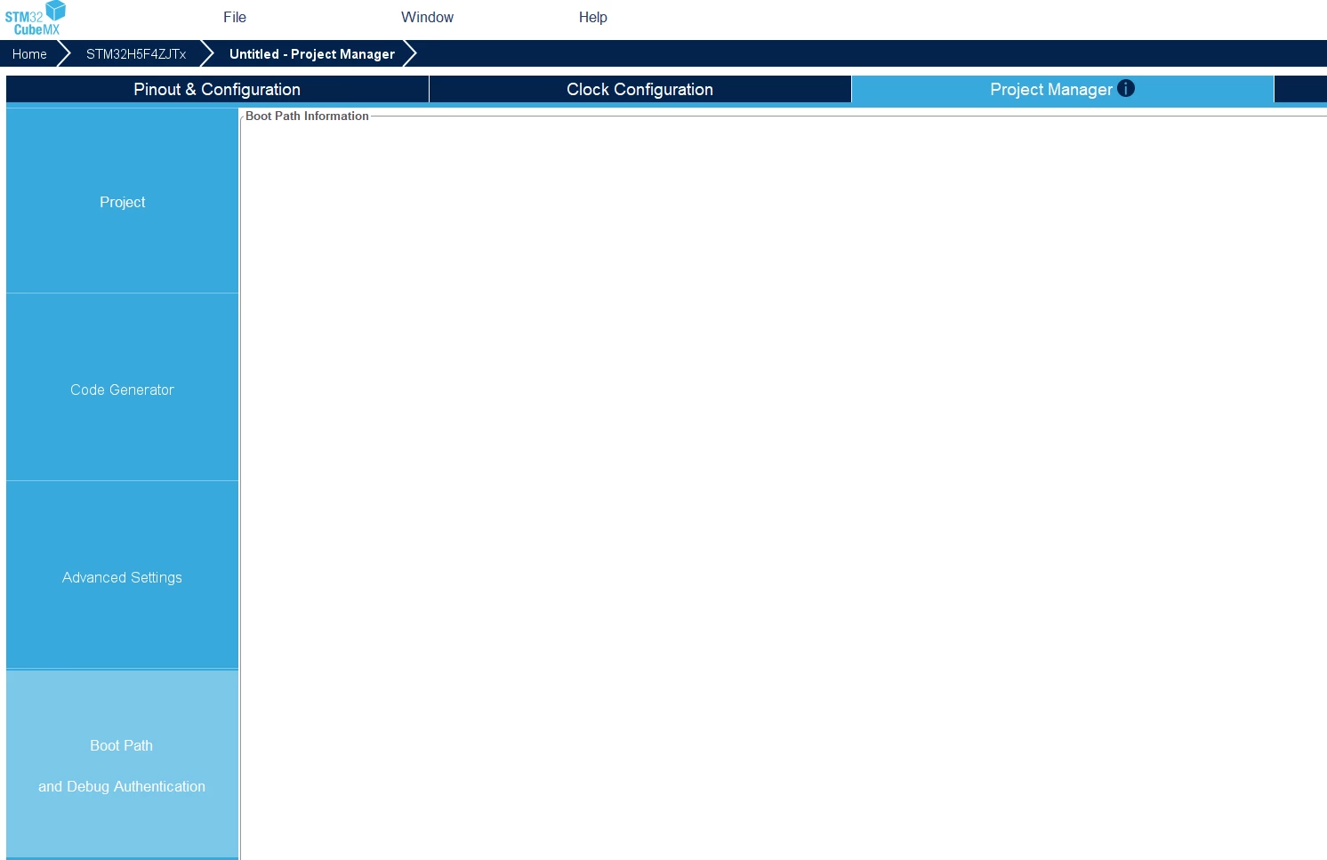

Hello ​@RJJ
We apologize for the inconvenience caused by this behavior. Our team is aware of the issue and is currently working on a fix, which is planned to be implemented in the upcoming STM32CubeMX release. In the meantime, a documented workaround is available in the Known Limitations section of the STM32CubeMX release notes available here:
https://dev.st.com/stm32cube-docs/stm32cubemx/6.18.0/en/docs/markup/CubeMX_RelaseNotes/sections/2_4_when_selecting_microcontrollers_in_the_stm32h5_series.html#release-2-4-stm32h5
KR,
Souhaib

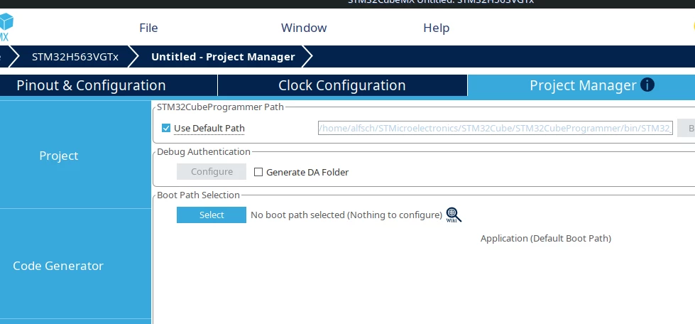

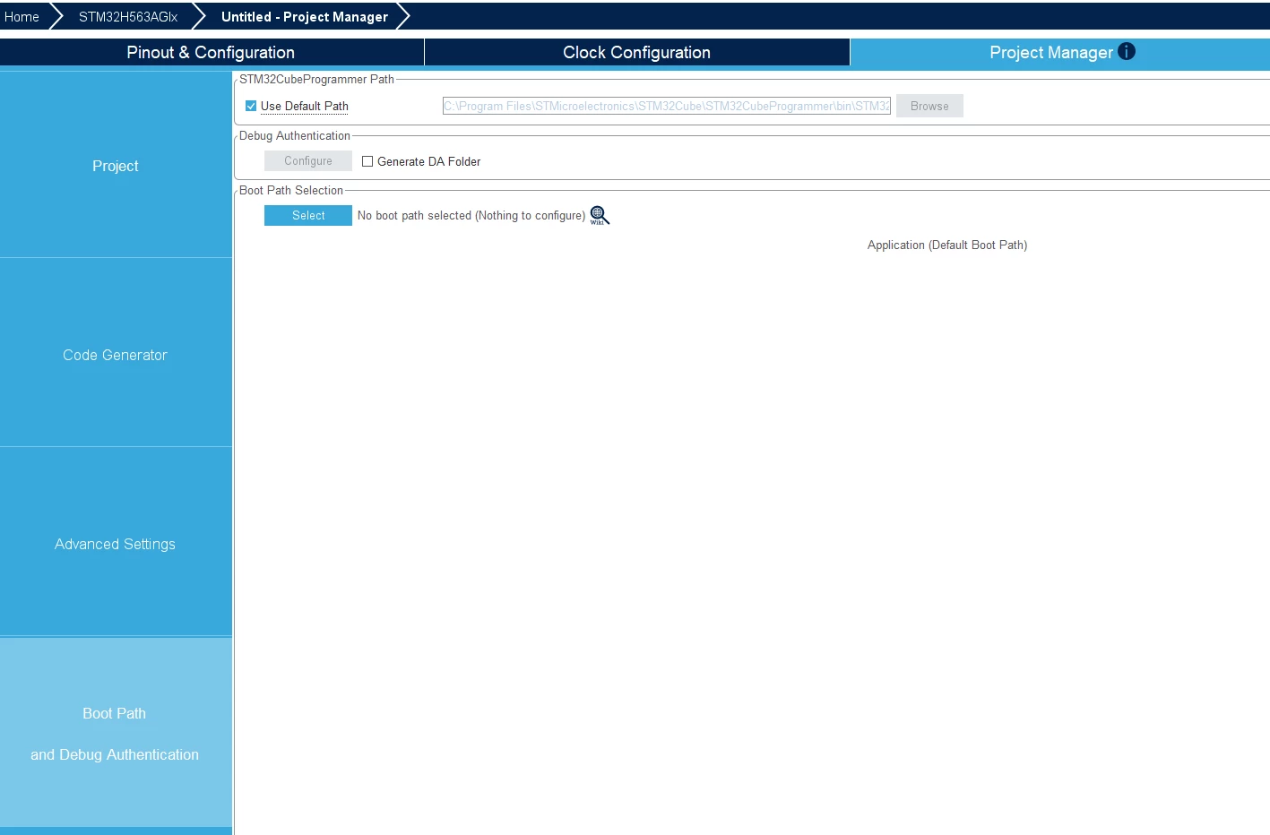

i tried on Mx6.18. , new project with H563, trust zone enabled :
You expect something like this ? I cannot reproduce your error.
Try again, do enable trust zone at beginning.

I created a new project using STM32H563VG, and the Boot Path configuration appears correctly. However, when I create a project using STM32H5F4ZJT6, the issue persists and the expected configuration pages are not displayed.

Thank you for reporting this issue. I have reproduced it from my side using STM32H5F. I will raise it will to the dedicated team for further investigation. Internal ticket number: CDM0065540 (This is an internal tracking number and is not accessible or usable by customers.)
