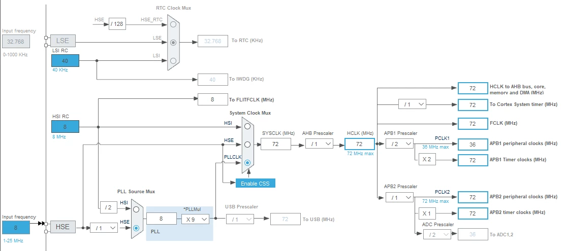

Board: NUCLEO F103RB I have this problem with UART, the serial monitor show: x⸮x⸮x⸮x⸮... Why i have this beaheviour? I use UART2 (PA2 - PA3 board pin) and I connect the board at the PC trought USB cable.

The attachment show the clock configuration:0693W000000TwCNQA0.png

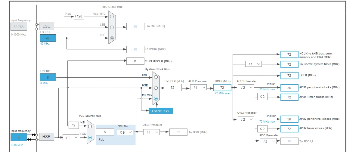

UART2 works correctly only if PCLK1 = 8 MHz with HSI source at 8 MHz. I want UART2 works correctly with the same of clock configuration on the picture.
March 23, 2020
Take a look at "6.7.1 OSC clock supply" in the user manual UM1724.
Set up the HSE clock in BYPASS mode and it should work.

I have change HSE in BYPASS mode: RCC_OscInitStruct.HSEState = RCC_HSE_BYPASS, however the UART print: x⸮
I think that there is a problem in BRR register. Why if PCLK1 = 36 MHz at 9600 boud the value of BRR is 0x00000068?
I think that should be 0x00000EA6 (36.000.000/9600). It is correct?
March 23, 2020
You have a clock problem somewhere. Note that 0x68 * 9600 = 1MHz so the system might be set at that rate for some reason. You should verify your system clock is getting set correctly. Or it could be a CubeMX bug.

This is the Clock Configuration:

Where could be the problem? The clock configuration is consistent with the picture ( CubeMX).

Below, i show RCC and USART2 registers. I see in RCC->CR register that HSE not ready (17th bit) and in CFGR HCLK divided by 16 (bit [13:8]). Someone can tell me another test for check of the clock functionality? I used uVision.

You are hard to help. You have no test equipment, you don't post a complete compilable project.
Check that the solder bridges (SB) for the MCO / HSE are present. This may depend on board version in uses, and most of the HAL examples for the NUCLEO-F103RB use HSI to clock at 64 MHz. Boards MB1136 C-01 don't have HSE connected.
https://www.st.com/resource/en/user_manual/dm00105823-stm32-nucleo64-boards-mb1136-stmicroelectronics.pdf
Check
SB54 ON
SB55 OFF
SB16 ON
SB50 ON
>>HAL_UART_Transmit(&huart2, (uint8_t*)p , sizeof(p), HAL_MAX_DELAY);
Use strlen() or sizeof()-1 so you don't transmit the NUL characters
This uses USART1 via PA9 / PA10, clocks the board at 64 MHz, you could modify this
STM32Cube_FW_F1_V1.8.0\Projects\STM32F103RB-Nucleo\Examples\UART\UART_Printf
Would be usable with a USB-to-CMOS Serial type adapter from SiLabs, etc.
