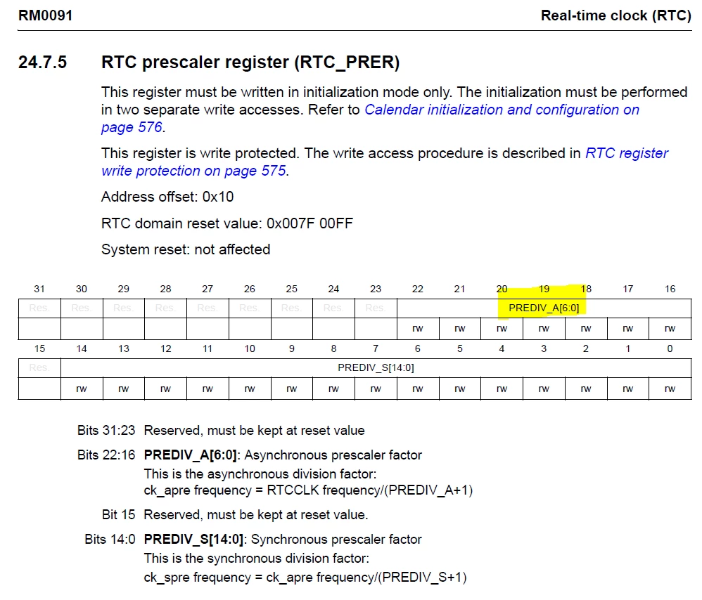

Asynchronous Prescaler RTC STM32F103xx cannot be set higher than 127 in STM32CubeMX
The STM32F103 does not have a Synchronous Prescaler. and the Asynchronous Prescaler can be set to (2^20 - 1) in the MCU.

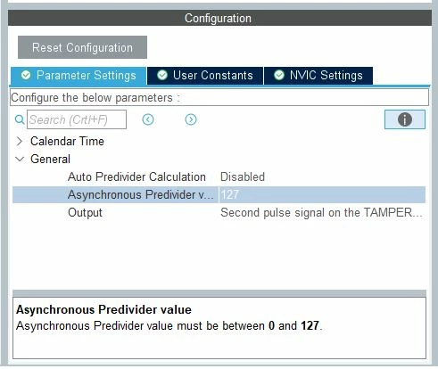

But STM32CubeMX doesn't allow a number higher than 127. Not really a problem of course, just a bit confusing.0693W000005D3m9QAC.jpg

Nov 30, 2020 1:05 PM UTC
Seems like a bug in CubeMX.
Some other families limit the asynchronous prescaler to 127, which is where the restriction comes in.
WilkoL
WilkoLAuthor
Senior
Nov 30, 2020 1:14 PM UTC
Those other families likely have a second Synchronous prescaler, the STM32F103 (all STM32F1xx ?) does not. So yes, it is a shortcoming in STM32CubeMX.

Hi @Community member​ ,
You're right, issue will be fixed.
Thanks for your feedback :)
