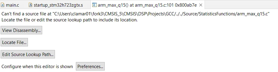

Has anyone seen this before? As I step through trying to debug why 128 points doesn't work it looks like the arm_rfft_fast_init_f32() call is the issue. No doubt related, but when I try to Step Into the rfft_fast_init() call I get the following error:
Can't find a source file at "C:\Users\clamar01\fork3\CMSIS_5\CMSIS\DSP\Projects\GCC/../../Source/TransformFunctions/arm_rfft_fast_init_f32.c"
Locate the file or edit the source lookup path to include its location.
Funny thing is I don't know who user clamar01 is...no user on my computer. I added the DSP module from X-CUBE-ALGOBUILD.

The absolute path ("...\Users\clamar01\...") seems to be a leftover from signal processing engineer "Claudio Martino" at ARM in their CMSIS library files. We get the same message when debugging, but in conjunction with a different function call ("arm_max_q15()").
Screen shot:ARM_ERROR.PNG

The easy way is not to debug CMSIS functions. Simply skip the functions when debugging. The orderly way would be to report this problem to ARM. However, I suspect this way is unsuccessful as the code parts were probably intentionally hidden in a library. The harder solution would be to use the free Open CMSIS package instead of the original ARM CMSIS library. In case of doubt, however, this may lead to new problems.
