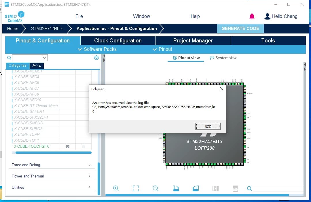

An error has occurred.See the log file. Error after added TouchGFX in CubeMX.
I am using STM32H747BITx MCU and i've try CubeMX6.12.0 ,CubeMX6.10.0.Still the same problem.
If I do not enable TouchGFX in CubeMX, I can successfully generate the code. However, if I enable TouchGFX, an error message like the one shown in the picture appears, and it cannot be compiled correctly in CubeIDE.

Hello @ChungEN,
I tested with STM32CubeMX 6.13.0 version and I am not able to reproduce the issue.
You can find in the attachment "ioc" file.
Thank you.
Kaouthar

It seems that CubeIDE does not support generating TouchGFX projects for the dual-core H747. The only examples I found that can be used are for the STM32H747I-DISCO development board, but that's not feasible for me. The MCU I am using is the STM32H747BIT6, not the STM32H747I-DISCO's STM32H747XIH6.

Hello @ChungEN ,
Are you test this behavior with the latest STM32CubeMx version 6.12.1?
To check the issue could you please share your .ioc and log files?
Thank you.
Kaouthar
