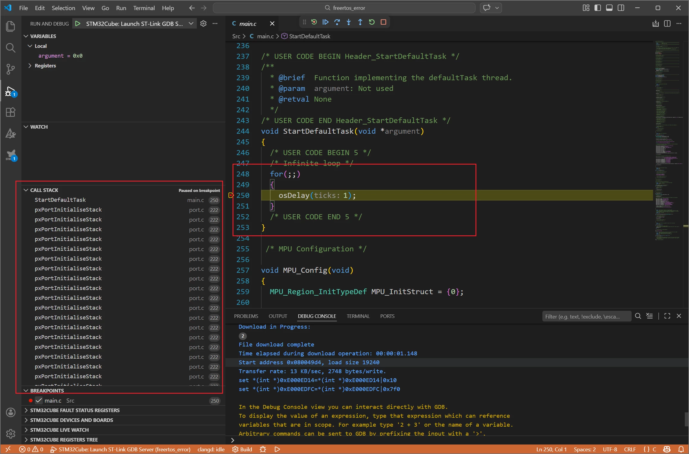

After FreeRTOS is started, the function call stack becomes full and the system crashes.

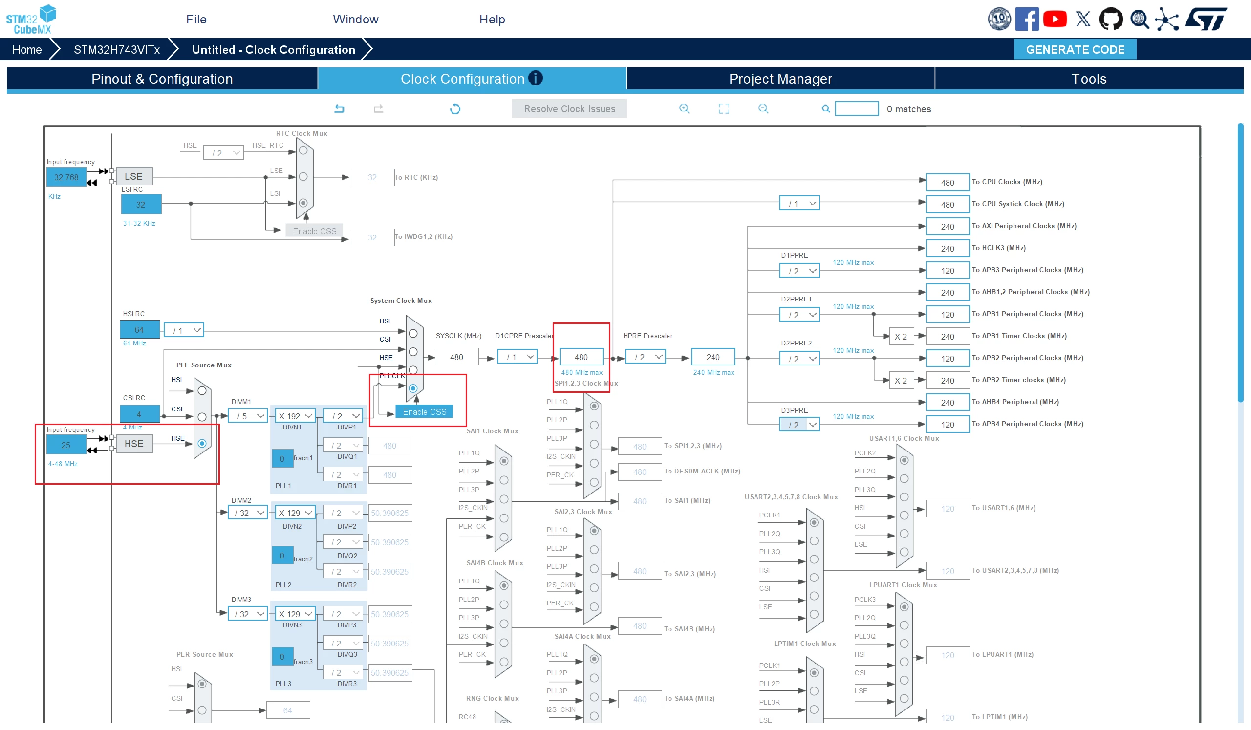

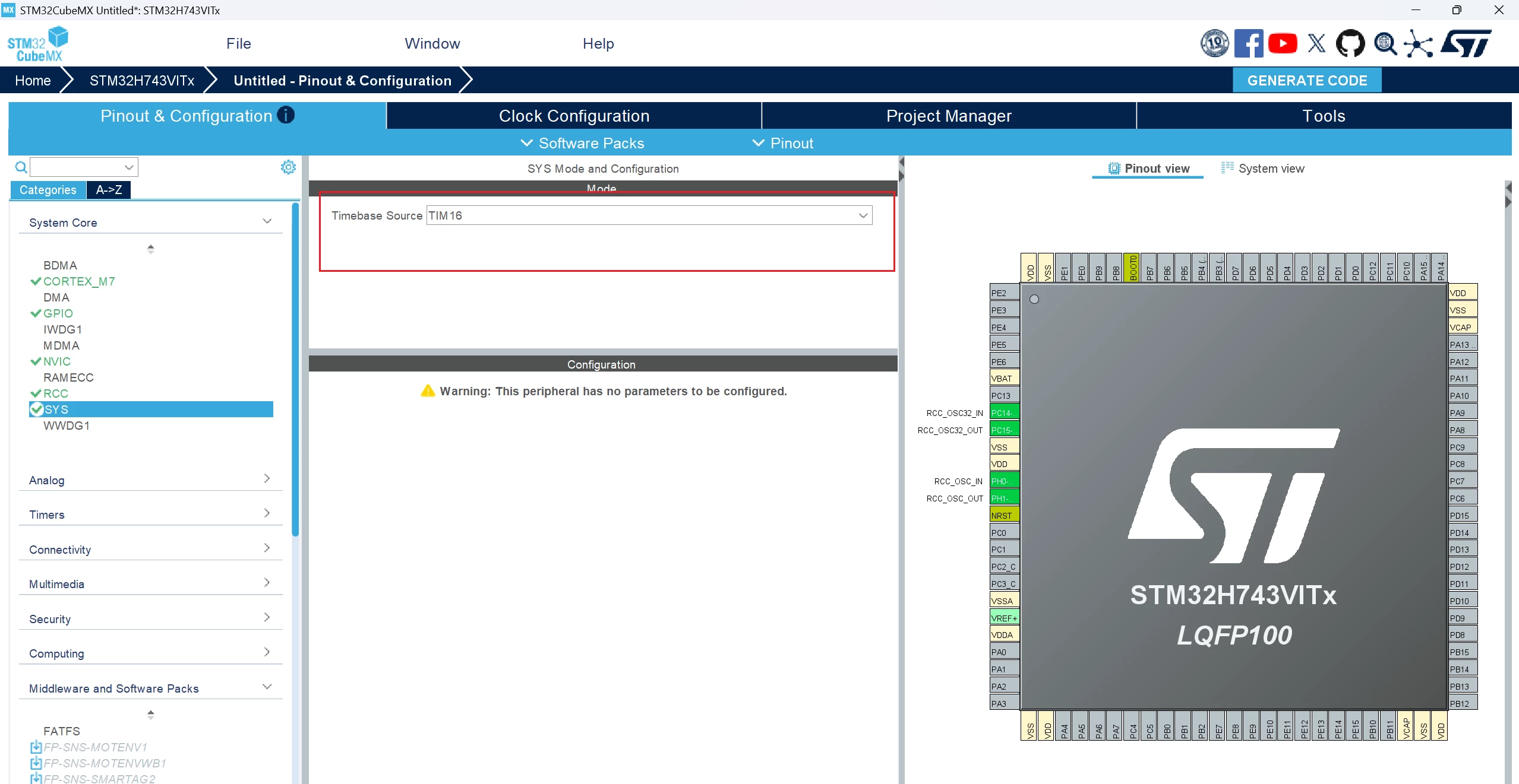

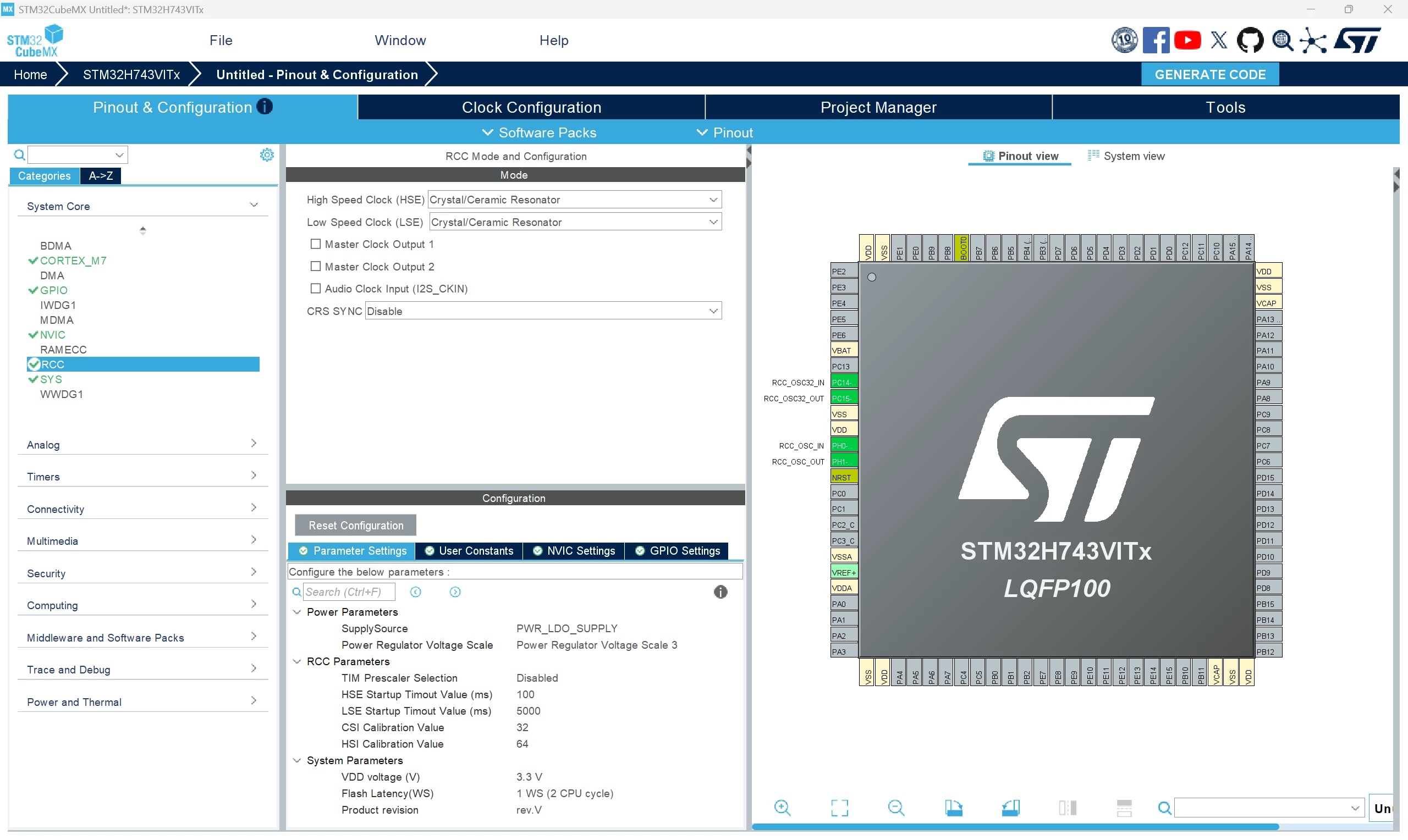

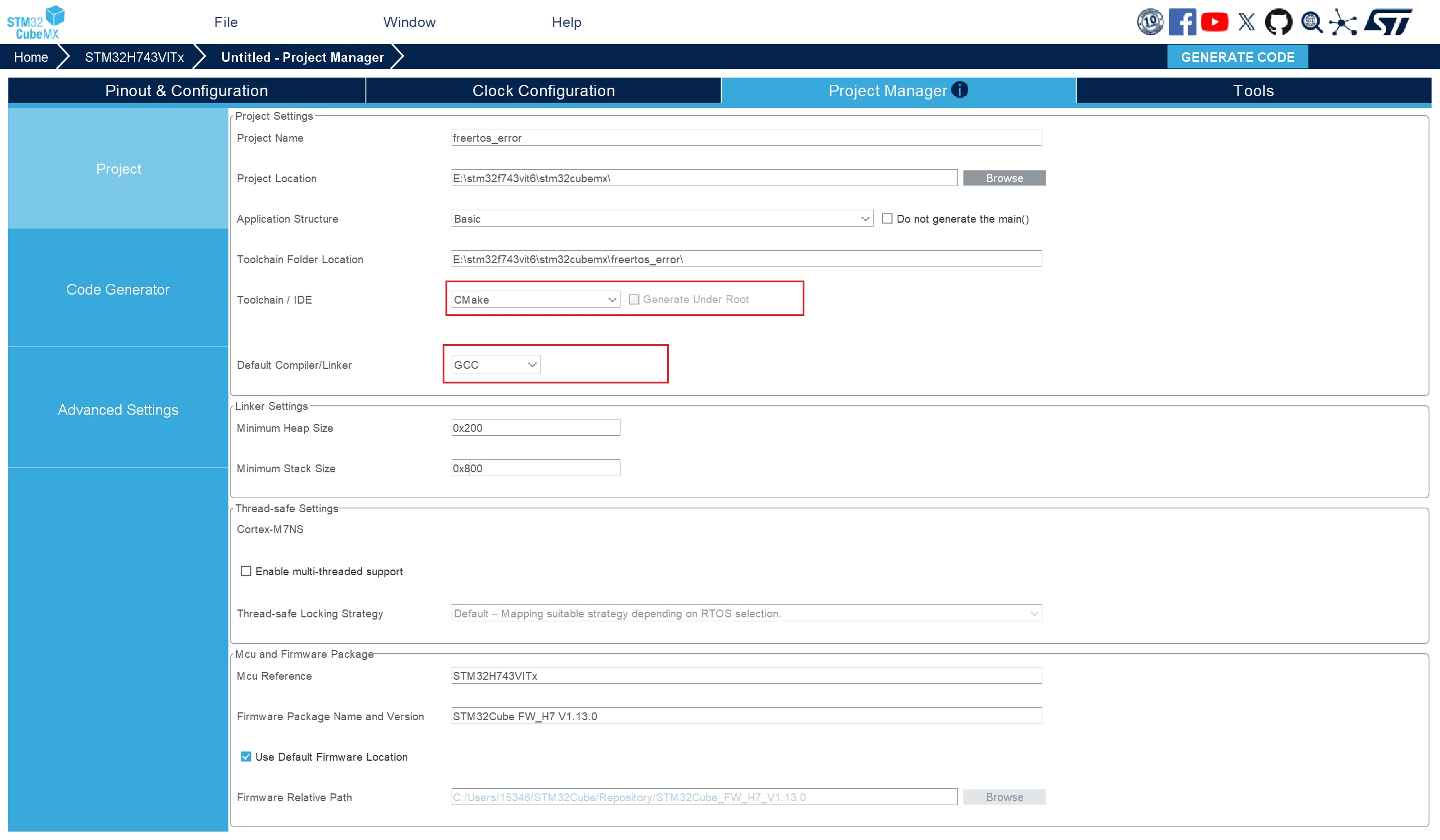

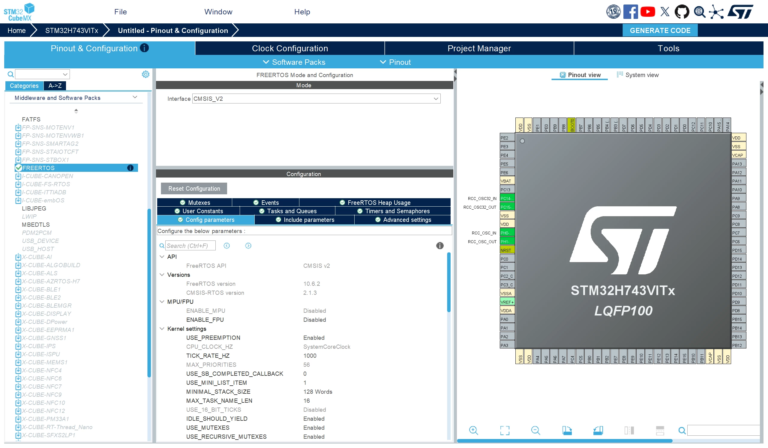

Create a FreeRTOS project, keeping all settings at default configuration. Use CMake for building. The steps for creating the project are as follows:
When the first task is initiated, a large number of recursive functions will appear in the function call stack.

How much memory is allocated to your defaultTask in the <Tasks and Queues> tab?
Increase that number.
You are calling osDelay, that is going to put stuff on the stack. You can check the remaining stack allocation by calling uxTaskGetStackHighWaterMark(NULL).
