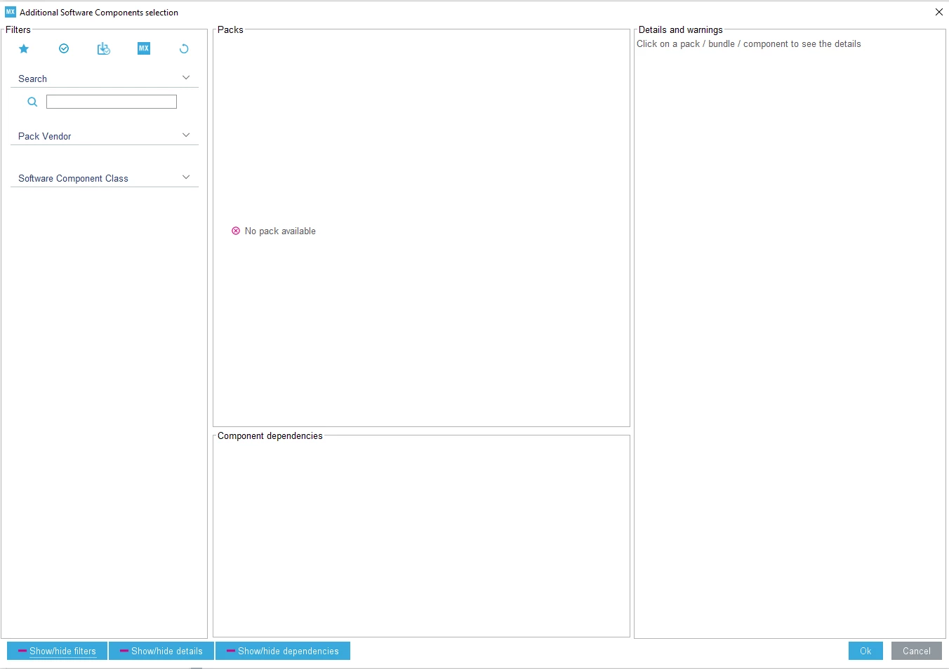

Additional Softwares is not displayed on STM32H747
Hello!

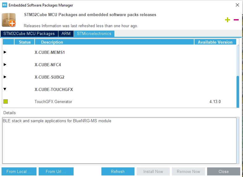

My problem is that I don't see the components in the Additional Software menu.
I did everything strictly according to the instructions specified of the official website. Components installed as shown.
CubeMX reinstalled, the computer rebooted, but it did not help. Touching Refresh button also has no any effect.
I use a STM32H747-DISCO
What could be the problem?

Hello @OBorz.1​ ,
Thanks for the feedback,
The Additional Softwares packs for H7 will be supported in the next CubeMX release (6.1.0) which will be available to download from site at the end of this week.

Mar 15, 2022 8:13 AM UTC
Hello @Khouloud ZEMMELI​
Currently, I am using stm32vubeide to create my AI project.
The target is to port neural network on stm32h745 (dual-core). But, nothing appears in the Additional Software Component.
I have checked the UM1718 User manual, where section 4.13 mentions that "This feature (additional software pack) is currently not supported for multi-core products."
What can I do to benefit from this feature using stm32h745?
Thank you,
-Moustafa
M.Saleh
Mar 16, 2022 9:39 AM UTC
I found the solution. In stm32cubeide -> Help -> Check for Updates.
My software required an update, so after the update, I was able to find all available packs in the "Additional Software Components".
