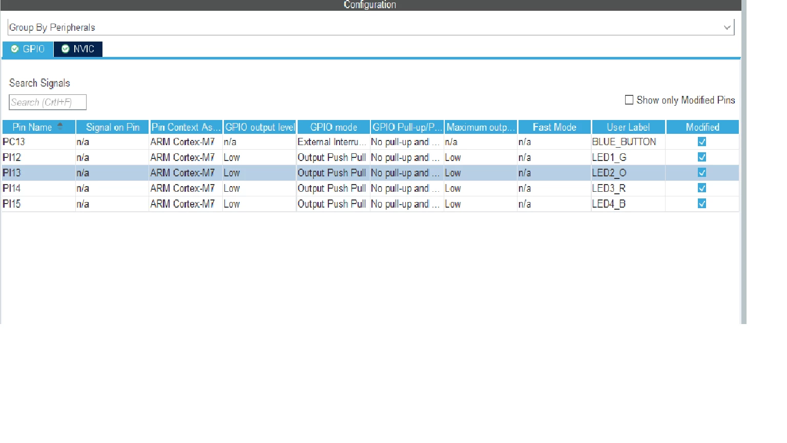

I had the same problem. The reason for me was pretty simple.
Since I am working on a dual core, I had to assign a "Pin Context" (M7 or M4).
After having assigned that, it worked as expected.
Here is a screenshot of the configuration
0693W000008GD9FQAW.pngHope it helps you too!
Johannes
