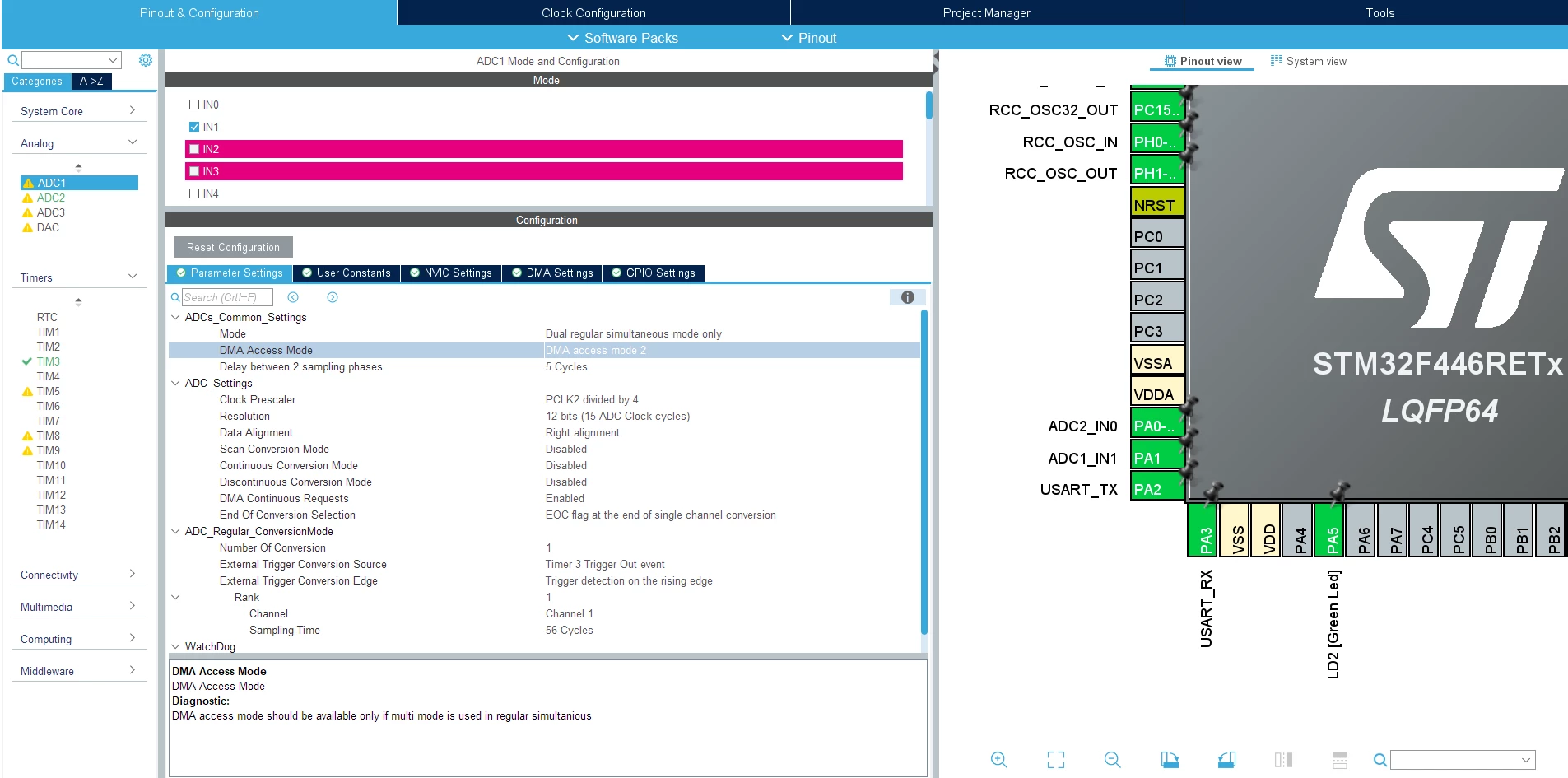

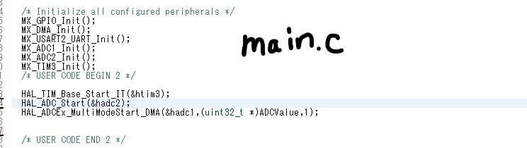

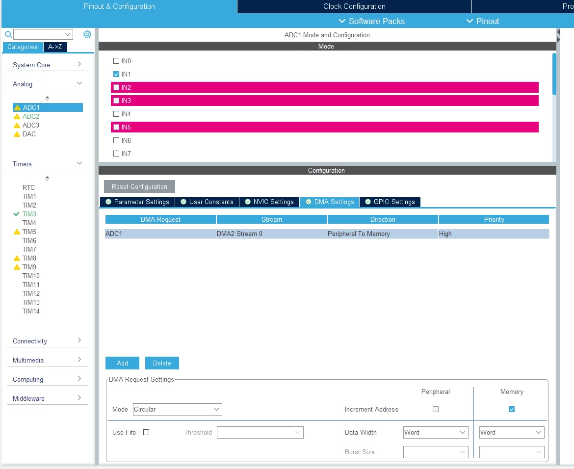

I want to run the ADC using DMA and Dual mode.

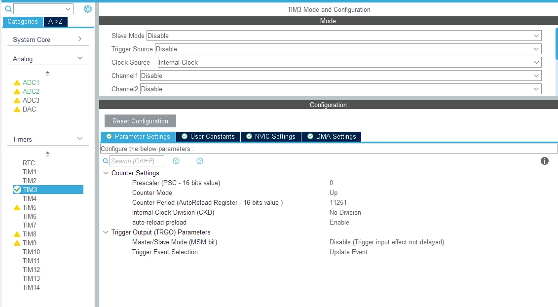

The sampling rate was set to 80kS / s using TIM3. The board I am using is Nucleo 64 STM32 F446.

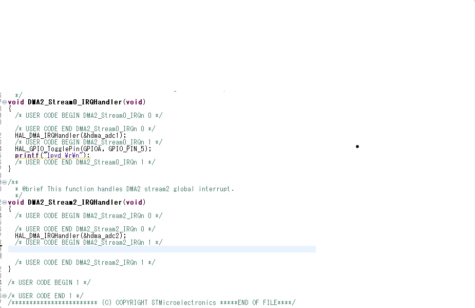

In order to confirm whether the ADC is really running at 80kS / s, I described "HAL_GPIO_TogglePin" in "DMA2_Stream0_IRQHandler (void)" and confirmed it by observing the pulse width with an oscilloscope.
As a result, it was found that the ADC is running at about 660us (1.5kHz in frequency). (According to the data sheet, the STM used can have a maximum sampling rate of 2.4 MS / s.)
Why doesn't my program get the sampling rate I set?
My program only runs the ADC and does nothing else.

Thank you for your reply.0693W00000GVzYFQA1.png0693W00000GVzY5QAL.png0693W00000GVzY0QAL.png0693W00000GVzXlQAL.png0693W00000GVzXWQA1.png0693W00000GVzXMQA1.png0693W00000GVzXHQA1.png

How is printf implemented? It could be blocking execution.

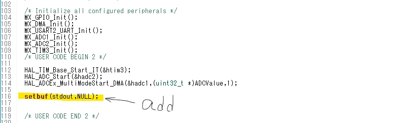

printf is implemented as follows.
Also, the buffer setting was missing, so I added it.
Also, when the printf described in stm32f4xx_it.c was deleted, the pulse width became 122us (8.2kHz).

A blocking call in the IRQ handler will certainly cause issues.

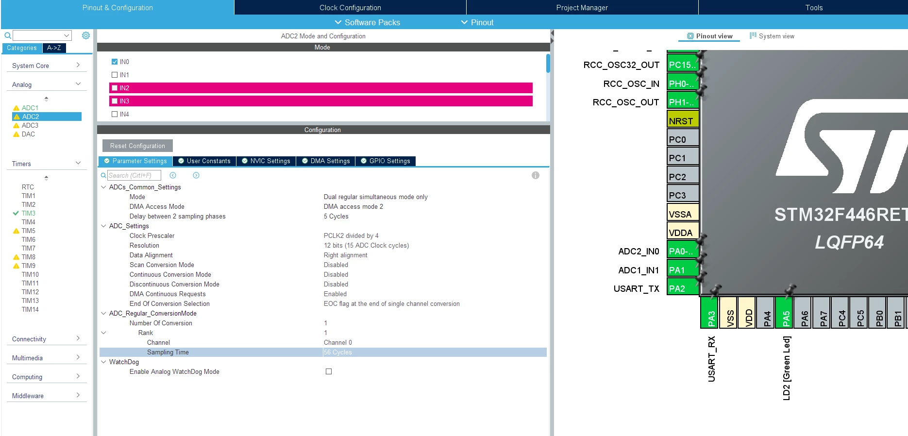

Your post mentions you were expecting 80kS/s, but your timer settings indicate 8kS/s.

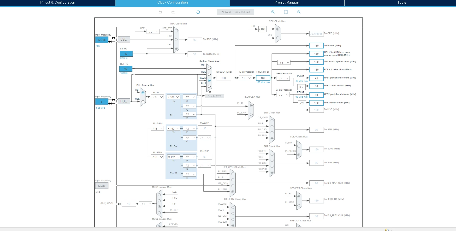

90 MHz / 11252 = 8kHz, so all is as expected right?

Fixed 11252 to 1125.
As a result, the DAM interrupt was generated only once, and then no interrupt was generated. (printf has been deleted.)
This phenomenon was confirmed by setting a breakpoint in HAL_GPIO_TogglePin (GPIOA, GPIO_PIN_5) of the first image "stm32f4xx_it.c". Immediately after the program starts, break only once with HAL_GPIO_TogglePin (GPIOA, GPIO_PIN_5). After that, if you press the resume button, it will not break.

Why would it work fine with 11252 but then not work with 1125?
Setting breakpoints and pausing the program is rather disruptive as timers continue to tick away in the background. Likely you're hitting an overflow type error as a result.

When I run the program without setting a breakpoint, the pin output toggles only once and there is no change thereafter.
I don't know why it works on 1125 but not on 11252.
I have set the sampling time to 56 cycles, is this too large?
