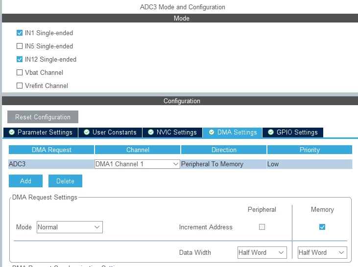

I've looked your CubeMx setup.
It seems TIM1 is only used to trigger ADC3 using TRGO internal event. In this case, do you really need TIM1 interrupt?
ADC3 in 8bit resolution in scan Mode for IN1 with IN12 in single-ended channels and using DMA request is also ok.
Concerning DMA Settings, I don't understand why Channel = ADC3 ?
It should normally corresponds to the physical DMA (like DMA1 Channel 1) (see my image below)
Can you check it?
The DMA is set in Circular mode. As your code start ADC3 conversion once, maybe it will be better to set DMA in normal mode.

  • TIM1 only triggers an event, does it mean no interrupt needed and TIM can be started with HAL_TIM_Base_Start() ?
  • Not sure why it showed "ADC 3" as a dma channel. I checked DMA channel cell - it shows correctly.
