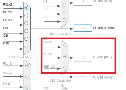

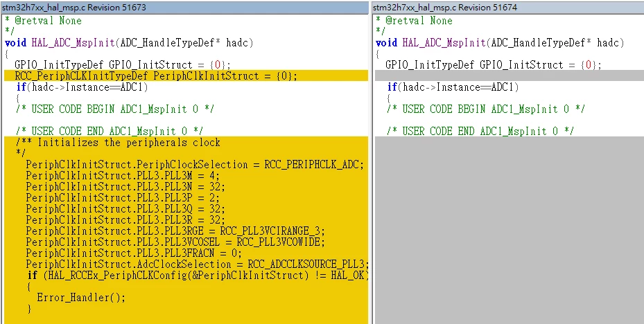

I am using ADC function on STM32H750IBK6 and everything worked perfectly.
But after migration to CubeIDE v1.9.0 and SDK v1.10.0, ADC can't work any more.
From "Clock Configuration" view, "ADC clock mux" is gray out for some reason.
Related clock source selection has been removed after code generation.
Is there any one can help me how to enable "ADC clock mux" correctly?

Hello @Engin Lee​  ,
Thanks for your feedback,
This is a known issue and it is already reported to the dev team to be fixed. I will keep you posted with the updates.
Internal ticket number: 124655 (This is an internal tracking number and is not accessible or usable by customers).

Hello @Engin Lee​ ,
This issue is fixed in STM32CubeMX latest release.
V6.6.0 is now available under this Link.
Thanks for your contribution.
