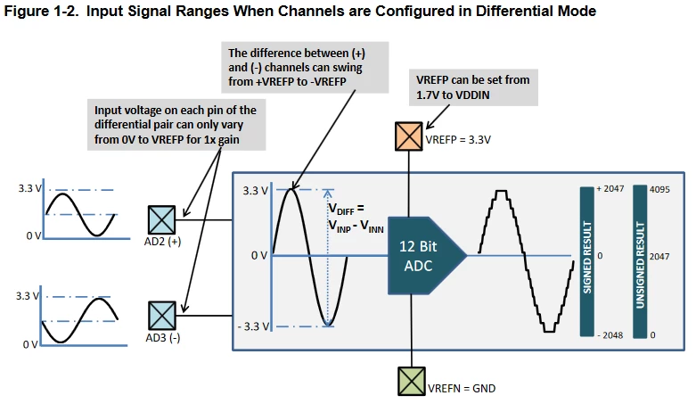

Look at the first waveform in Figure 1-2. Absolute voltage range at AD2/3 is 0...3.3 Volt only. Nowhere there is a swing +6V6 to -6V6 . In side the chip, there is no OP, only sampling capacitors.

Both inputs are within 0-3.3V, but differential can be 0-3.3=-3.3V to 3.3-0=3.3V.

You could have 6.6 V differential peak to peak (based on 3.3 V for REF+) and all is within the datasheet:
First sample (16 Bit):
AIN1+ = REF+
AIN1- = REF-
=> INT16_MAX = 3.3 V
Second sample (16 Bit):
AIN1+ = REF-
AIN1- = REF+
=> INT16_MIN = -3.3 V
