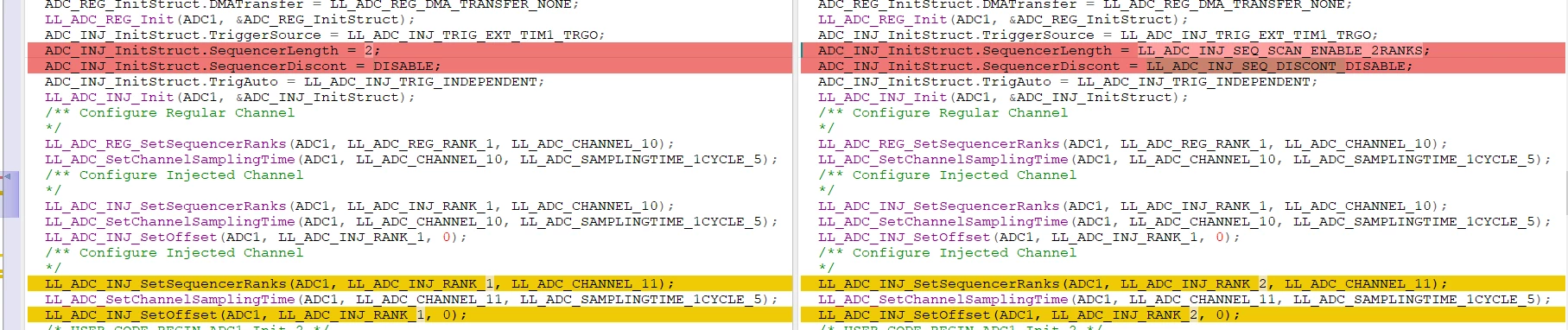

It does not work. E.g., if 2 injected channels are configured, ADC_INJ_InitStruct.SequencerLength = 2 is set from code generation tool.
But it should be ADC_INJ_InitStruct.SequencerLength = LL_ADC_INJ_SEQ_SCAN_ENABLE_2RANKS
LL_ADC_INJ_SEQ_SCAN_ENABLE_2RANKS is not equal to 2, but (0x1 << 20)!
I still need workarounds to get the desired behaviour.
Best regards, Fabian
FMink.1
FMink.1Author
Nov 22, 2021 4:18 PM UTC
There are several other Bugs.
Code as it is generated (left) compared to as it should be (right):
