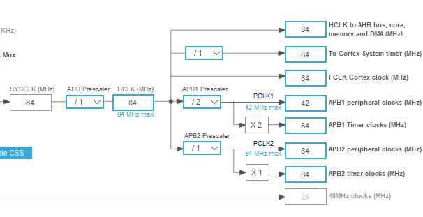

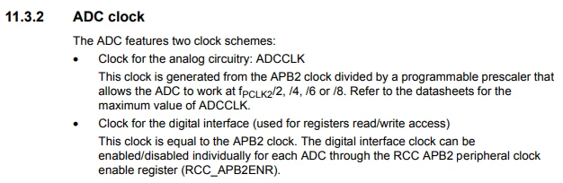

giwonKIMAuthor
August 21, 2024
ADCCLK is shown in the Datasheet like this.
If I set APB2 to 60Mhz and clock divide to 2, is it correct that ADC operates at 30MHz?
